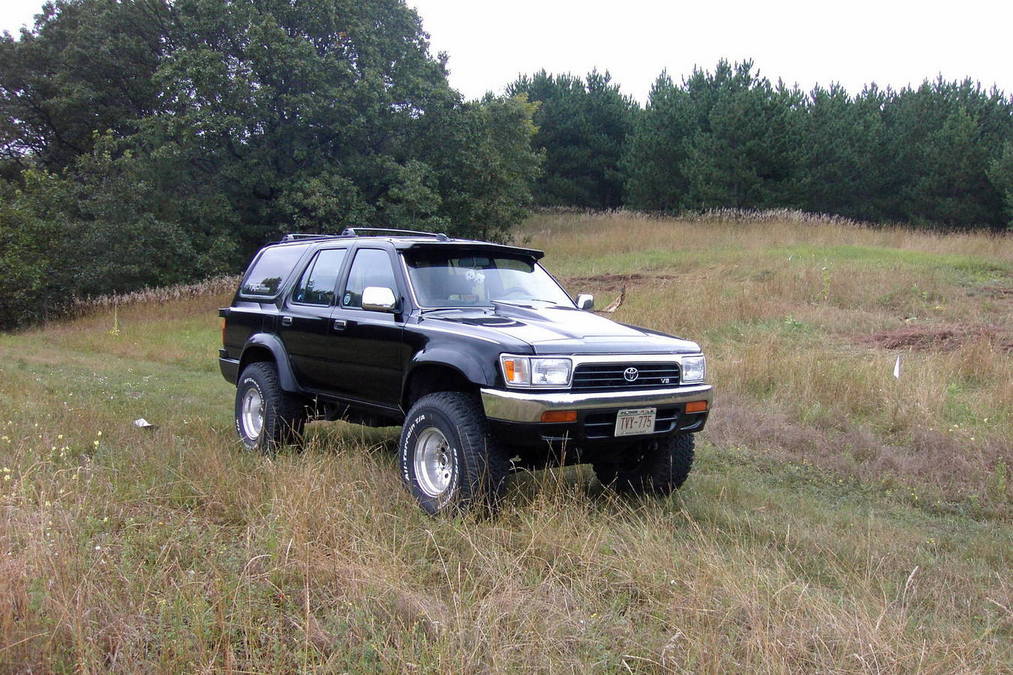

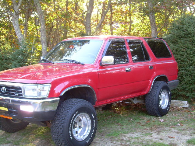

    I'm looking into something like the below picture. Would you say this is more than a -32 offset? I don't know what a -32 would look like.
    Oh Nana, what's my name?
    Stormy had -50s I think, though my -32s didn't look far off that
      -32.
      http://www.hiluxsurf.co.uk/forums/sh...39&postcount=1
        Thanks. I was also looking at this: All I can find from American Racing is the -43 offset 15x10
        Going by the -32 pictures the AR rims might stick out beyond the surf arches.

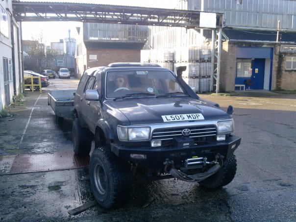

          Our 15x10" MT Classic II's are -48mm offset, they stick out past the arches a little, about an inch.

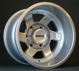

              I've been eyeing these wheels - 15x10, -29, -41, -53 offsets available, not 100% sure if they come in a Surf pattern.
                Look quite nice! Do they sell those in the UK?
                  They're Compomotives - UK company. I can't find any online prices.
                    They fit Landcruisers, so they'll fit Surfs.
