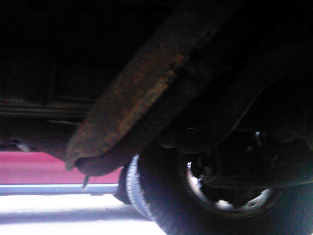

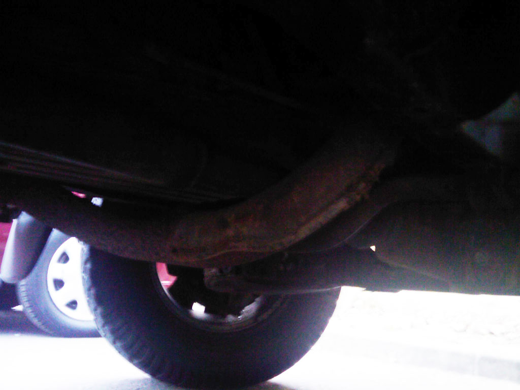

Hi mate, just a quick question, Lee (Don Logan) came over today to do the BJ and diff spacers, question is regarding the diff, we didn't think about it till we'd removed the two diff mount bolts and then noticed that you cant lower the diff enough to fit the spacers as it hits the exhaust and the ARB, this is a standard exhaust and his truck is a 2nd gen 3lt, have you had this problem crop up before?
