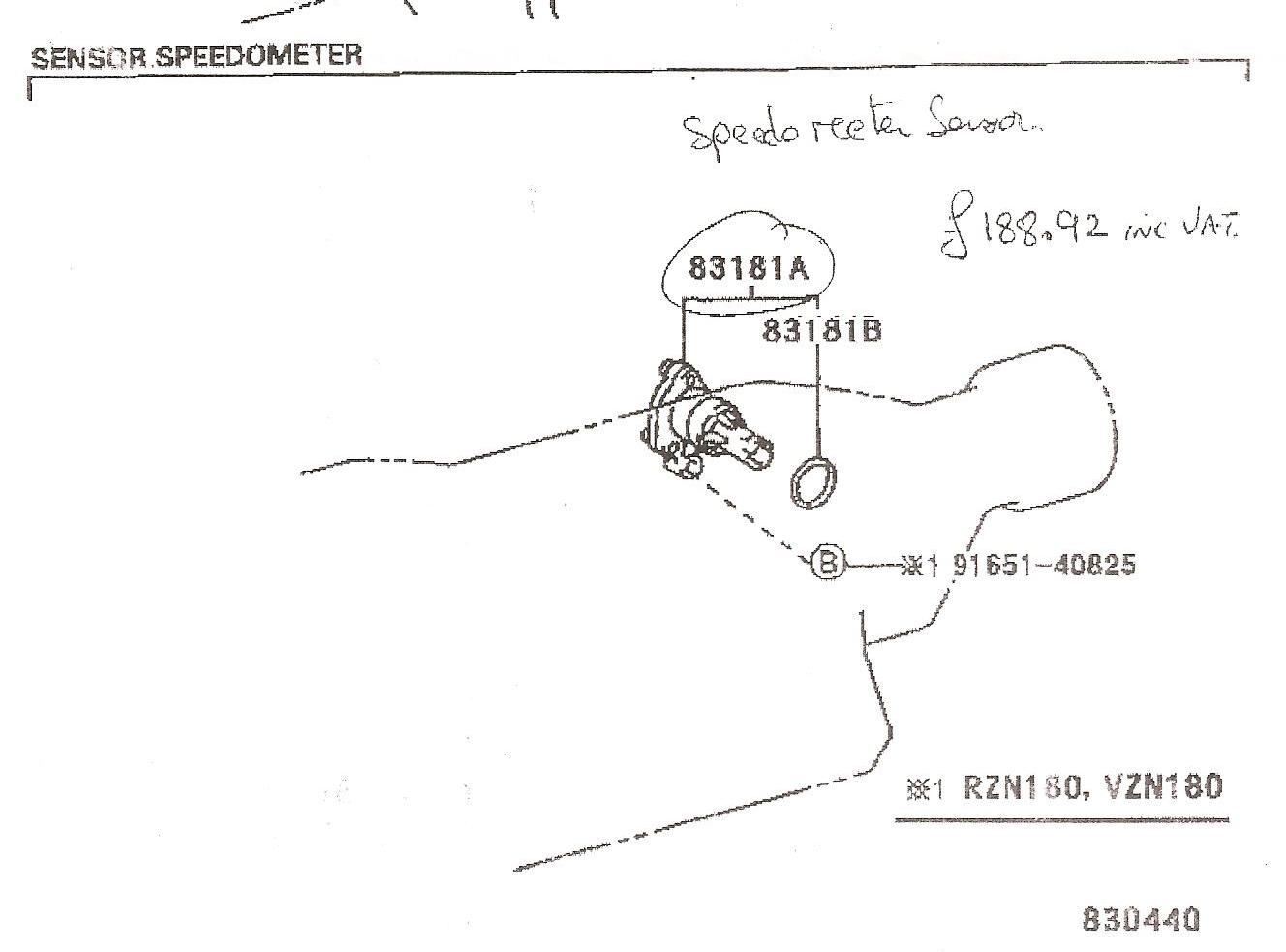

    Was hoping if any member knows where to pick up one of these without going to Toyota. They're quoting £187 for the sensor. I put a add in the wanted section, but so far, no luck. So is there anywhere else, somewhere can obtain one of these. 2nd hand or a copy of one. Also, can I use one from a different model from my own '96 3.0lt. Any good advice, much appreicated.

            83181-12020 is the part number if you want to check they quoted price for the right one.

                  That looks like the part I need Nifty, certainly the same part number that Toyota gave me.

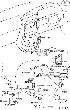

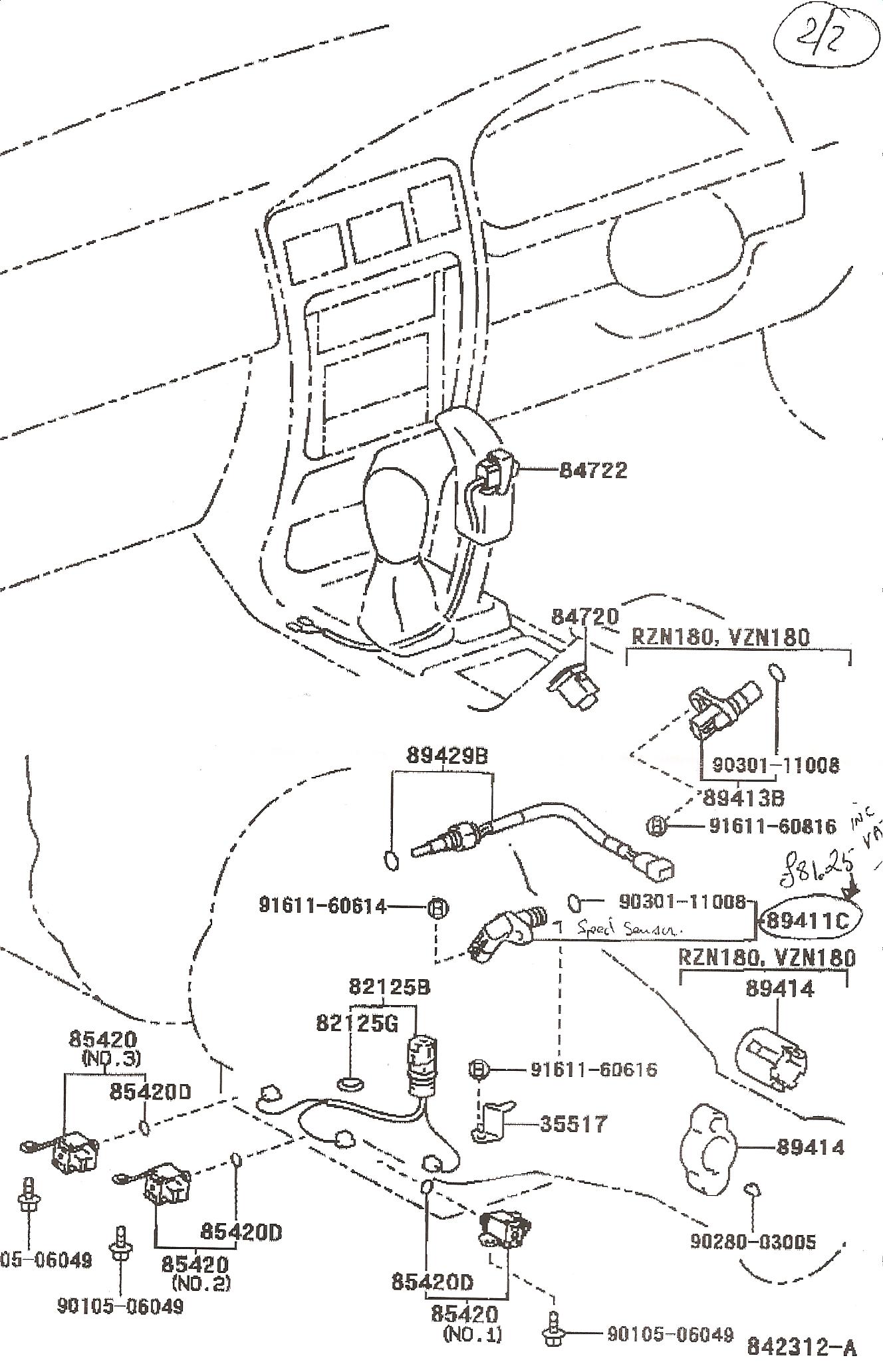

                    If its any help to anyone. Two sensors on the gearbox. Part # 83181A that sits on the outside of the gearbox & the other part# 89411C which sits on the inside of the gearbox.
