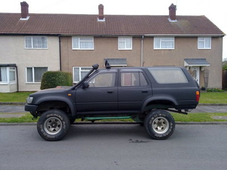

an extra 2"
  • an extra 2"
    thanks to oneintheeye for the free rear shocks and the help doing my suspension lift
    i now have 2" body and 2" suspension and its looking good
    now just to do the matt black respray, hopefully today

        Now it needs some bigger tyres, those look sort of "lost" under there
          Agreed but it's obviously a decent setup so far.

            is that 2" body and 2" suspention spacers?
            did you have to change anything under the car extend everything or did the kits just fit and cause no problems, I want to do the same but worried about the amount of work dont want to take the car off the road longer then a day, and dont want to spend more then 200 quid doing it

                  well i now have the matt black paint on it
                  took 2 hours to do the full paint job from start to finish
                  i love it
                    looking good matey..have you changed the dampers.?? You'll have very little articulation if not, especially 'droop' (oooo er). If you do change the dampers, dont forget an extended brake line as theres a good chance you'll snap the stock one the first time you flex the rear..
                      I'm loving that paint job!!

                        Excellent stuff - out of curiosity, what prep/paint did you use?
                        I've done similar things with bikes before and I've generally taken the old paint off with Nitromors (or similar), then primed & painted with Halfords spray cans, in between LOTS of wet & dry fine sanding and plenty of T-cut to get out imperfections. I'd guess that with matt black theres a bit less hard work to do?
                          basically ive keyed the old paint up using a red scotch pad all over, then degreased it with a panel wipe,
                          next step was to mask up anything i didnt want paint to go on,
                          the paint i used was cellulose high solid matt black so basically it doesnt need any clearcoat laquer over the top,
                          it was thinned down 1-1 then sprayed using a devilbiss gti gun
                          it doesnt require any polishing afterwards
                          but i have been doing paintwork for over 9 years now so its second nature to me

                              What are the chances of doing another one sometime? Kidderminster is on the way down to the in-laws and I'd quite fancy something similar for my surf sometime!
