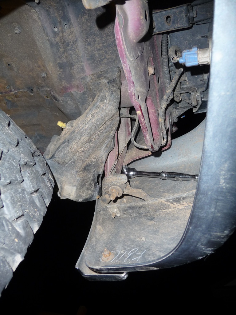

No problem, there's a few threads here about how to do it once you get the wing off, but that's the hardest part. All the bolts but one are visible enough - in the door post, along top and bottom of the wing and behind the side light. The other one isn't... see the pic below, looking up at the end of the bumper, with the spanner on the completely hidden bolt.Originally posted by Vultch View PostHi Andy, I might seek your advise sometime i fancy fitting my snorkel and I'v never had the wing off before....
If you've any reason to have the bumper off, do the snorkel at the same time.Andy
