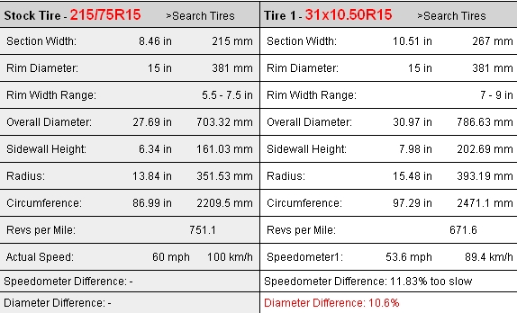

      Your 215 x 75 x 15 is in inches 28 x 8.5 x 15
      The 31 x 10.5 x 15 would fit the rim but I would imagine with no mods they would be far to wide and tall and would foul on the body ect.

              31's will fit with a 2" BB
              Sent from the iPad you "lost"
                Only if he has at least 7" rims.
