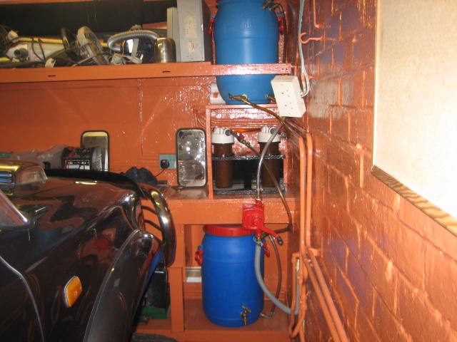

            I use greenteam filters for my wvo processing and can recommend them.
            I use 50ym socks and three of their 10" housings in series with 25ym-10ym and 1ym elements in them. - cheap too!!

                that has got to be the first time i have ever seen a garage with a dado rail!
                very posh!!
                Everyone thinks I'm paranoid!!
                  Dado rail!, your not looking at the water pipes are you,?
                  the paints just a load of verious colours i had knocking about, all chucked in a 25lt drum and rollered everywhere, just happened to turn out lobster pink
