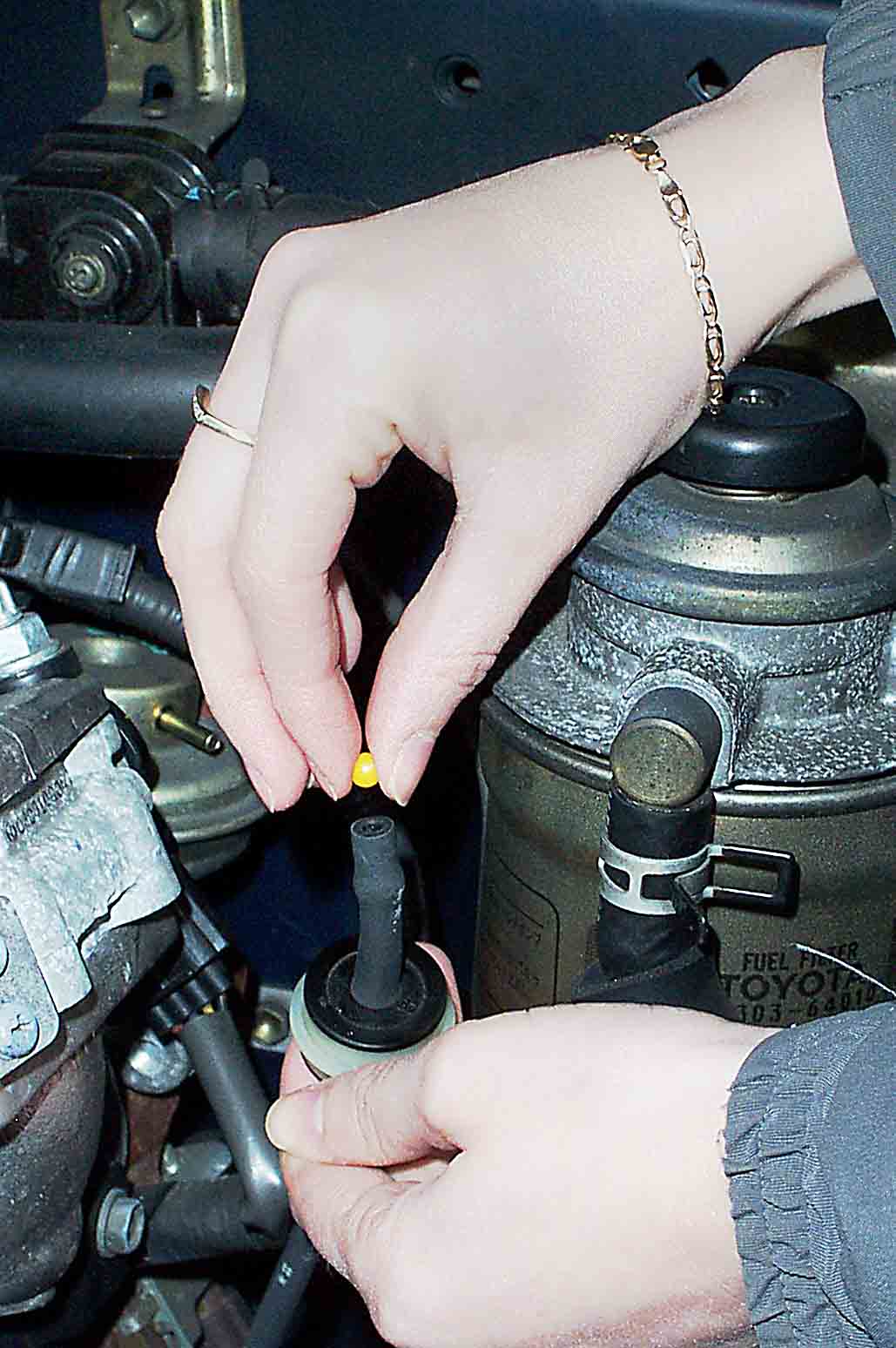

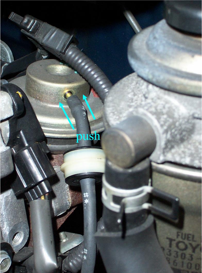

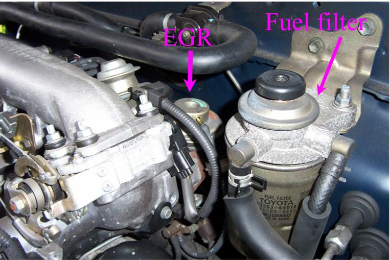

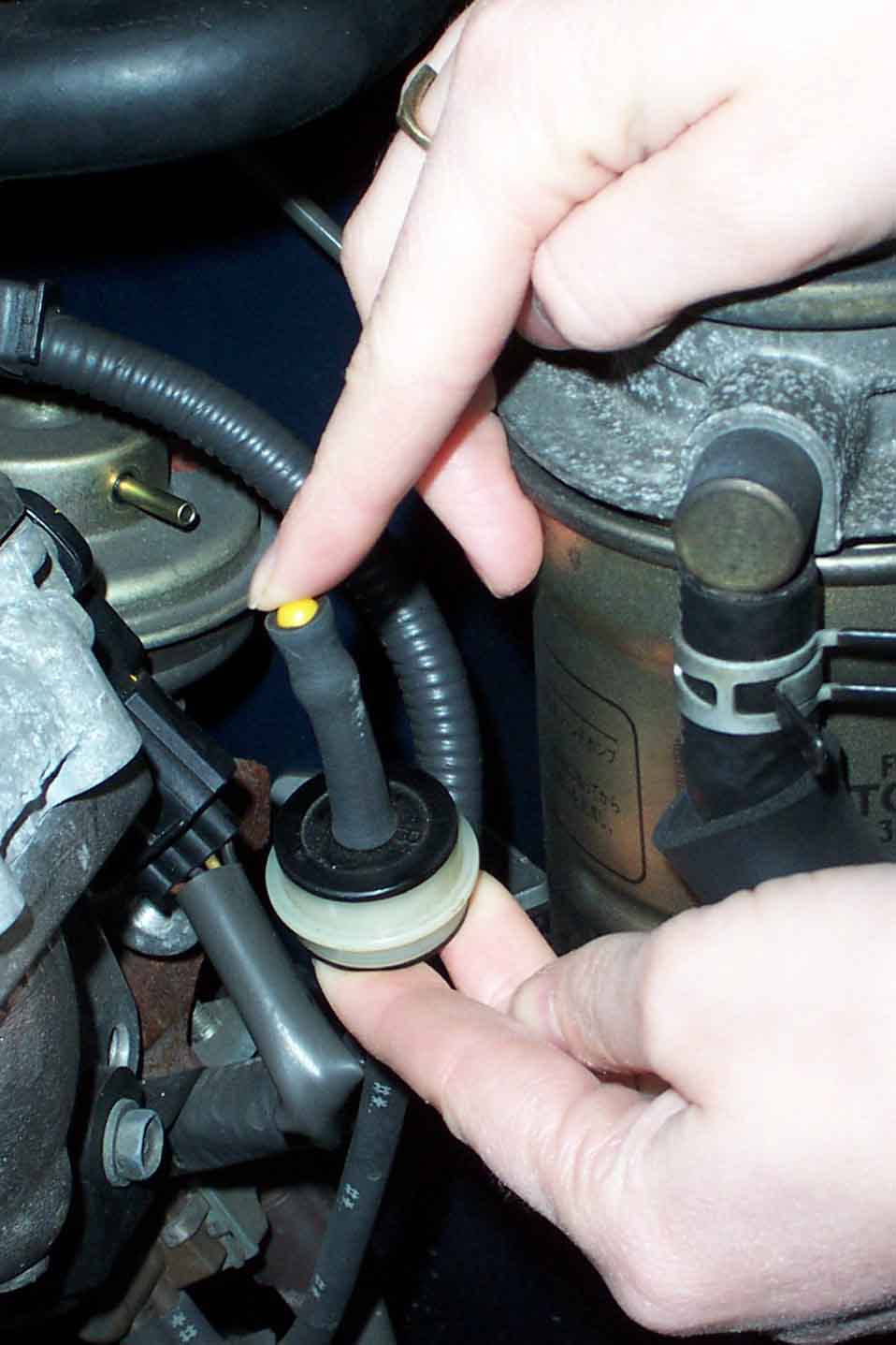

                      here's some picies of how to do it with a 6mm ball bearing or similar sized plug!
                      1) locate EGR valve - next to fuel filter
                      2 pull off hose exiting top right
                      3) insert ball bearing (plastic BB shot in my case) into open end of hose and push all way in
                      4 replace hose over EGR valve pipe - just to keep things tidy and secured out of the way.
                      (and yes - I do have lovely hands for a 16 stone hairy ar$ed fitter!!)
