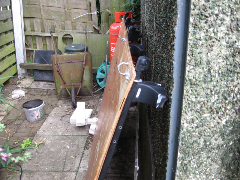

    Just received Boycies roof rack/platform. Its made in the same way as Bundubashers with a sheet of ply held over 4 roof bars. Its great and very sturdy but whereas Bundu made it with Marine ply, Boycie used normal ply thats been varnished. Its held up pretty well but as its easy to do it now I want to treat it with something to cope with the lovely English weather.
    I plan to paint or varnish it just on the top and sides as I would guess that if you do the whole thing, water will inevitably get in somewhere and with no way of breathing it'll rot from the inside out?
    any ideas of what would be the best treatment? Ideally not gloss as i will be walking on the roof sometimes and some sort of textured coating would be best, but at the end of the day the most important thing is to make it last.

    The main difference between exterior ply and normal is the glue that holds it together. Moisture makes interior ply de-laminate. I'd seal it all over rather than leave any bit open to the elements.
    Personally I'd spend a few bob and buy a sheet of marine ply. (I get the other type free at work and I'd still pay for marine)
    Rob.
    Looking at the pic I'd also go for something thicker - 18mm maybe ? The ply in the pic is warping between roof rails and doesn't look at all sturdy.

      HI, the best thing to seal the ply is epoxy resin, varnish is a waste of time, you would need to re varnish at least 2 times a year, epoxy resin will seal it extremely well, apply minimum of 2 coats, use a fresh roller each time, pay particuler attention to the edges, and coat all sides, make sure you wear rubber gloves as it is nasty stuff if you get it on you. Use marine grade for a good tough durable finish,try this company www.epoxy-resins.co.uk.

          which ever product you use to seal the ply - add a cup or so of kiln dried sand (block paving joint filler sand) - this will give you a non slip surface on treated areas.

              Been looking into coatings and Epoxy looks great but too pricey- looks like it'll cost around £50. Still wonder if PVA with sand in might do the job to an extent without breaking the bank?
              Marine ply to size is going to be about £100 so at this stage I would rather cope with it as is and replace in the future if and when I have to. It does look warped in the pic but its not that bad in the flesh/wood.

                  I was looking at some MP online and it seemed to be coming in at a ton for the right size (18MM ply) where can you get it that much cheaper.
                  Might just PVA it and if it starts warping I'll replace then...
