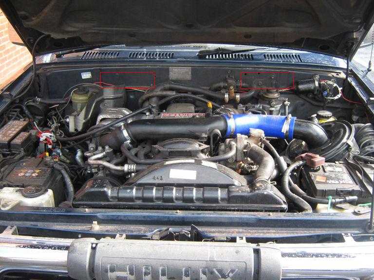

    not sure if this is possible or legal (firewall) but any ideas would be appreciated
    have been looking at fitting bonnets vents to help get rid of the hot air in the engine bay but worried about excess water getting in would this work and would it fail its MOT or anything

      cheers wiggy was thinking that but dont really want to hack the bonnet to pieces and add loads of vents as i have plans to add a side mounted intercooler with scoop in the near future and dont want it looking like a scooby
      was thinking 2 big holes maybe with a duct running to the top vent to ensure air is expelled using the convection of the air moving over the bonnet

            You could do what i am in the process of doing, 2 round bell type vents, similer to the aftermarket ones for motorbikes, above and to the rear of the front wheel arch, with ducting to engine bay, we deal with tempretures upto and above 50 degrees here and so far touch wood, no overheating problems. in the mock up i done it lowered the temp by a couple of degrees around the engine, but it gets hot by the doors. You could also do a body lift, this helps the airflow around the the engine and lets more air escape. The engine bay is a confined area so its airflow you need to look at, on the surf valance at the front is some indents for fog lights, you could cut these out and using wire mesh and glass fibre, make another bell type duct, with tin cooker hood type ducting to improve the airflow.

              thought about modifying the bonnet hinge so it's slightly raised at the back?... just an inch.
                  as far as i understand the dynamics of the air presure piping more air into the engine bay changes the air pressure which may have an adverse affect on air through the router maybe wrong ? my suggestion would work as the bonnet hinge idea but wi think look tidier

                            i read somwhere on here that adding say a foward facing scoop that spat air into the engine bay would infact increase the air pressure under the bonnet and affect the airflow through the rad not sure how accurate this is but can see the theory behind it
                            but what do i know thats why im asking
                            cheers
                              You do have to release the air thats coming in but you have a ###### great opening at the bottom of the engine bay, so I doubt a couple of little scoops will make any difference to 'pressure' at all. All this might be applicable when you reach 3 figure speeds, and will be important at 4 figure speeds, but at the 'ice floe' type speeds of a Surf it's likely not important.
