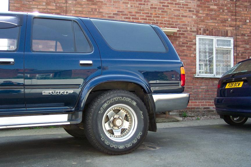

How come you got a different number Marky, pic looks similar colour to ours ...Had enough... going to live in Spain....

How come you got a different number Marky, pic looks similar colour to ours ...(\__/)
