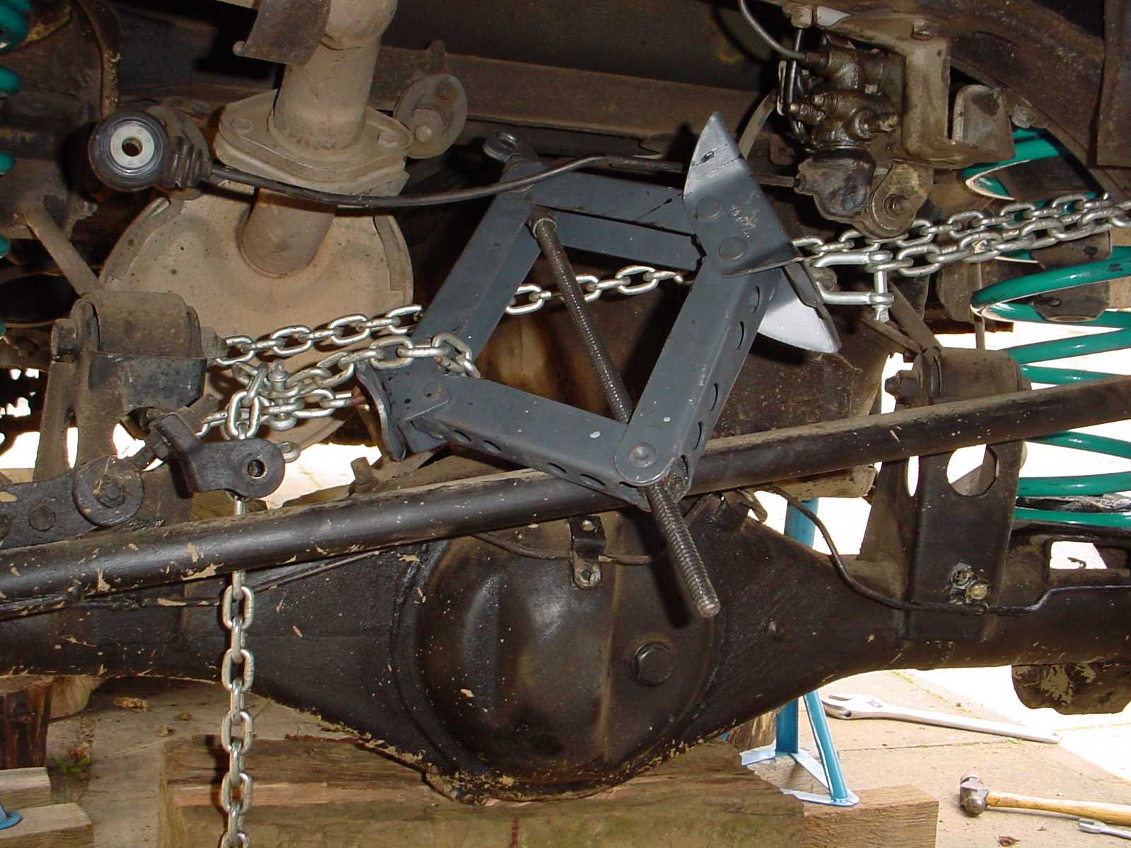

I managed to sort out my problem with the rear axle being out of alignment. If you are changing your springs without a spring compressor, whatever you do, don't undo the horizontal(ish) arms that go from the front of the rear axle to the body.
The RH one was undone on mine yesterday and th RHS of the rear axle moved back about 1.5".
I had a flash of inspiration and put the bottle jack horizontally between the back of the wheel arch and the hub, with a couple of bits of wood for protection. I wound the jack until the bolt holes were aligned and did it all up. After a test drive everythings settled nicely and a check with the ruler shows that the back axle is back in position.
She drives lake a new truck now but I think I will leave the steering idler bushes until next weekend.
