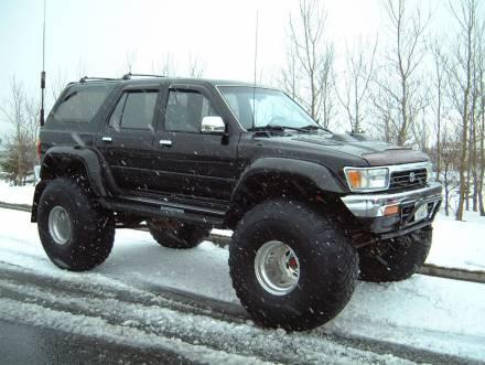

Is It Possible To Use A Pickup Chassis With Leaf Springs Setup On A Hilux Jeep (92) In Order To Raise The Suspension Above 10 To 11 Inches ? Or Are They Different Wheel Bases Etc

Sounds Impressive El But Do You Have Any Idea Of Costing For This Job And Who Could Do It ? Not Using It For Offroad At This Time Just Want To P*** The Bloke Off Who Has A Humvee Over Ere Lol Plus Every Time I Look At That Picture I Just Need Info Onnit Which I Havent Been Able To Obtain Supertrux In Daventry Said 11 Inch Lift Max From Them With 35 Inch Tyres But Is A Bit On The Pricey SideITS GOOD BUT ITS NOT RIGHT ?
