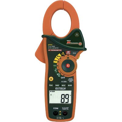

    tried an amp clamp?if not borrow/buy one,u wont look back
      No I havn't but then again I don't know what one is, maybe you could enlighten me.
            odd looking clampin,it detects any electrical draw inside the clamp,so u start at battery and work yr way back,really handy tool,u just keep following to the source of the drain
              amp clamp
              dont know if it works on 12V though

                  Originally posted by blackpoolsparks View Post
                  amp clamp
                  thats the kiddie,i have one that goes down to 6v
