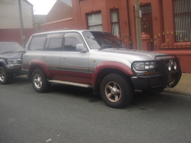

                  Things to watch out for (expensive ones)
                  Fuel Injection pump leaking - not cheap to have rebuilt , budget around £500 +
                  Suspicious tapping noises from the top of the engine that don't sound like tappets - could be big ends on the way out - however if you catch them before they destroy the engine (if they go expect a rod through the block) they are 3 hours + around £100 for parts (Big Ends and bolts).
                  Gearbox that doesn't work properly - I'm talking Auto here. They are exceptionally reliable however if there are major noises or clunks then they are expensive to rebuild (same for transfer case).
                  Lots of clunk on takeup. Could be a sloppy front diff. Again very strong and reliable and will go on for ages with a knackered front diff).
                  Leaks around the front swivels - need a front swivel rebuild however this is not hard or even that expensive and should be done every 60-100K miles anyway.
                  Apart from that they are built like brick outhouses. The 1HD-T engine if you don't have big end probolems (affects a few but is not catastrophic unless they completely go out on you) is good for 350K miles plus without major work.
                  One last thing, check for lots of grey smoke when you boot it - could be injectors need replacing and these cost aroun £350 to replace at a decent diesel place (or £250 per injector at Toyota plus labour).
                  You can't really go that wrong with an 80 especially the Diesel although the Petrol is good too especially if converted to LPG to keep the costs down). The engine is not that particular about dirty fuel as long as you change the fuel filter regularly so it's good for overlanding.
                  The articulation is immense so off road it's spectacular (as long as you don't run into width probles as it's a big beast).
                  The Axle locker actuators can stick but can generally be sorted out without replacing.
                  Imports will be unlikely to have front and rear lockers (although some have). most likely won't have leather electric seats but will have other toys like a fridge, front/rear split A/C (on some), some have the camping kit (fridge and cooker in the back), some have a factory 3 inch lift and 33 inch tyres, factory Winch - I retrofitted one on mine and while it is rated only at 3.6 tonnes it will do it all day.
                  Look at a few, don't jump for the first you see. There are a lot of abused ones out there and not so many really good ones, however the right one can be found within your budget - you could probably get an immaculate 12V 93 or 94 or maybe a later 24V one (95-98) but not in such great condition but still nice and reliable.
                  Have a look on www.tlocuk.co.uk/forums for further advice or have a look at http://ih8mud.com (a US site but a mine of info on Petrol and Diesel models).
                  I also have a site at www.landcruiser-rocks.co.uk although it's only just been relaunched with new software so it's very quiet.

                            So, a late model 4.2 TD 80 series, UK or Middle East spec, with Factory Fitted Winch and 3" lift is what I really want?
                              Alright Andy. How's things.As mentioned the BEB's( big end bearings) seem to be a problem. Most say about the 100k mark but thats only what i've heard. So if you can get one thats had em done your onto a winner.
