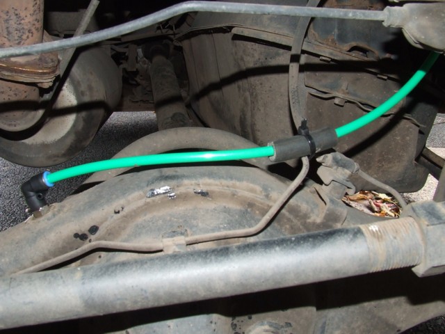

    As I plan to go offroading at some point I thought I'd change the diff breathers for extended tube breathers, I did the rear no problem but I can't see the front one, anyone know where it is positioned on the front diff?

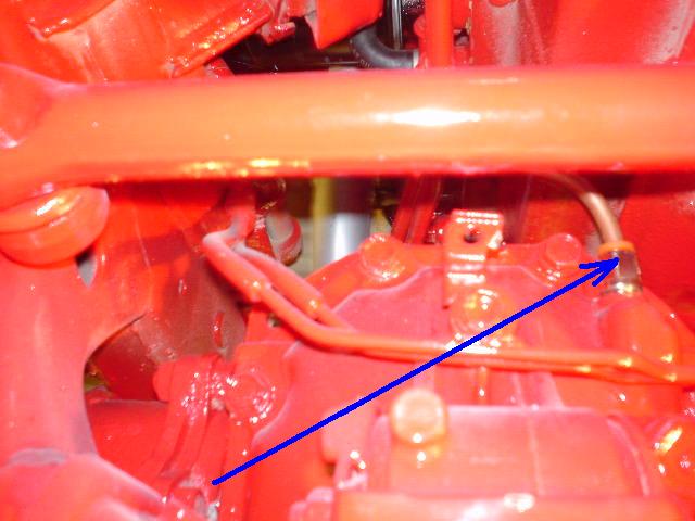

    It's on the top, just to the left as you look at it from the front - but it is a bugger to get to....and to replace with an extended one too..
      Thank you, I'll have another go at it in the week, the ones that are going in are 90 degree angled, I'll feed the pipe up through the engine bay & through the bulkhead, that should ensure that it doesn't get water in, the rear one was easy as I put it up through the floor & put rubber hose on it where it is likely to rub, there is enough pipe that it will flex & be enough to do the body lift without having to change it.
      With the angles & the plastic pipe it has cost less than £10.

        Thats it, like he said! a sod to get at
          Bl00dy hell, it looks like you could eat your dinner off that diff, are we looking at that from the rear? I can't get orientated.
                        Ian
                        Yeah! thats from the front, as said it's a whole lot easier with a body lift, i used a push fit straight fitting with a angled lenght of 8mm copper micro bore and come off that with 8mm id silicon tubeing, i've yet to do the one on the gearbox, the rear ones easy and i teed the fuel tank breather into that one,
