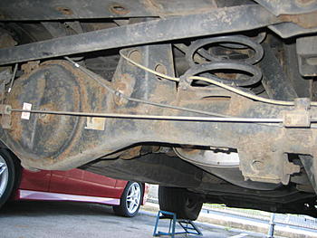

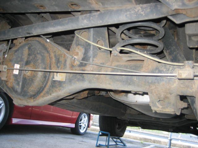

    Can I get anyones opinion on the state of this Surfs undercarrage? Thanks!

        Its not too bad, how long has it been in the country?
          This is a 1996 Gen3, imported 2003.
          Is that an average condition for these trucks?
          Still dithering about what one to buy, seems to be a lot of these trucks coming and going on the sales sites...
            It's rustier than mine.

              It only appears to be surface rust, which is nothing, a good couple of coats of underseal will sort that out,the engine would be my main concern when buying.
                Personally I'd avoid it - if the importer couldn't be bothered to get it undersealed what else did he skimp on ?
                There'll be a better one along shortly
                  I have a 1993 that was imported in 2003 and it has a lot less rust on than that one.
                  Roy
                  When ya stop having fun, Ya start getting old
                    my 92' has far less rust. Avoid it and wait for a better one!!

                      It looks familiar
                        Hey peeps, thanks for the opinions!
                        Hey POPEYE - yes indeed this is the photos you took of the Portsmouth Gen 3 you very kindly went and had a look at for me :-)
                          That would be far too much rust for me. Only buy one that's got good quality underseal from when it was imported.
                            if the surfs good,i think yr mad writing it off cause it isnt undersealed,which aint exactly a massive job
                              The breaker i just bought from Wales was never undersealed and its still in very good condition so knock a few quid off of the price and get it undersealed.As long as there is no really bad rust on it then it will be ok i should think
