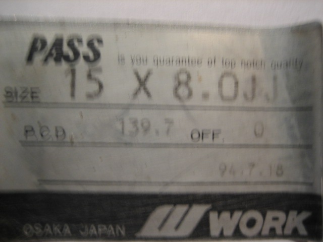

    lastly (for now) i added the lable that was stuck on the inside rim, (only one that the printing survived), not to clear but it says, pass your gaurantee of top notch quality size 15X 8.0JJ, pdc--139.7, off 0,
    so looks like 8" rims but i'd have guessed 10", short of removeing the tyre i dunno, however you reccon there's no probs fitting a fatter tyre on em?

    poo in my ear anytime lol,the tyres u linked to would fit,but before u buy,when do u need them?see my thread on tyre sizes oh yes that means your wheels are 8 inches
      The 8JJ is the width and shape of the rim, jj refers to the shape, don't really need to worry about it. the 8 bit is width in inches.
      So they're 8" wide rims.
      12.50 tyres should be ok on them, wouldn't want to go any wider.

                    Looking at the photos you posted yesterday I would have thought you had 10" rims Ian, they looked massive. I thought I was on a winner when I found out my 31x10.5x15 tyres were pracically level with the edge of my rims, but after taking a wheel off I found mine were also stamped up 15x8JJ!
