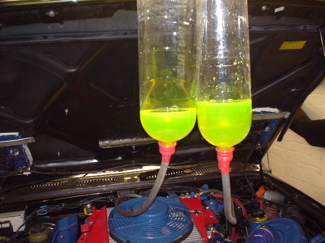

                Roy, if your heads ok now you should be perfectly ok to just fill as normal, run it up to temp (so the stat is open, and cap off) then top up as it goes down if it goes down, dont think you'll ever get all the air out without doing summat like matts done, but if the engines alright it should'nt affect the running, however if you can solder copper tube it's best to make up some "tee's" and fit em in the heater pipes at the highest point, i made two, (flow and return) and use some plastic bottles connected to both drain cocks,
                fill up from cold via the cap and when full refit the cap and start the motor, open both drain cocks and fill both bottles 1/2 full with coolant, you will see the coolant drop in one bottle and air bubbles enter the other, top up the one dropping till no more air is realeased in the other, leave running for a bit and then shut off the drain cocks and remove the hoses/bottles etc (without tipping whats left all over the engine)
