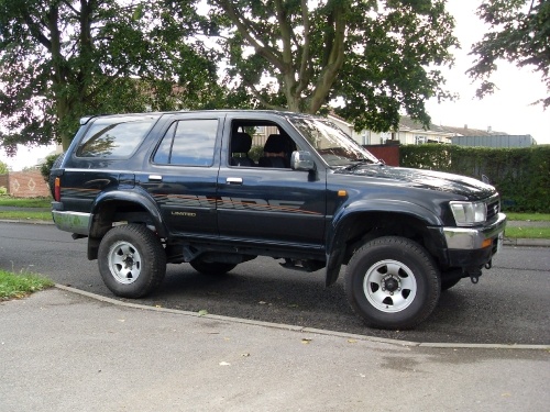

    I've started the build.......
    Standard
    Body Lift 2"
    Suspension lift - +2" Coils and +2" Spacers
    Just waiting on a set of 33/12.5/16's to turn up and a snorkel (I decided I need one after the 3 dead turbos on the grey one!)
    FYI Wheels will be for sale as soon as I have found a set of original wheel nuts.

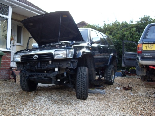

                              Seems to be running ok. Have had a couple of good runs and it has missed fired a couple of times, but only minor ones. I think its electrical and I'm going to take the immobiliser out as I think its the cause.
                              Just need the wheels and tyres! I want to play! (And not break it!)
                              Problem is I need to lengthen the anti tramp bar as it pulled the axle over too much with the 6" lift and the tyres will protrude too far on one side! Also will need to get the tie bars on the anti roll bar lengthened as it is counter acting on the springs so I have removed it. Makes for an interesting drive around corners .
