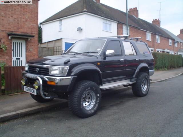

what size wheels and tyres are these ??
  • what size wheels and tyres are these ??
    a members surf i believe , looking for something the same size , looks like its been lifted as well ? cheers jon

        Looks like 2"body lift and 2" suspension lift
        Running 33" tyres
        Brian
          Looks like steel chrome spoked 15x10 wheels and 33.12.5x15 tires.
          Alan
            The Tyres are an older Kumho tread - 834 MT. The size is 33x12.50r15 on 15"x10" rims.

                    Hey thats mine!!
                    its a 2" suspension and 3" body lift with 33" tyres but they have 3" spacers. think the same affect was done by Apache with a bigger offset wheel this would be better than using spacers i guess.

                      Forgive me if I misunderstood, but are you saying that you have 3” spacers between the hub and wheel? I have always steered clear of using spacers on safety grounds… 3” sounds like an accident waiting to happen.

                        i`m sure they are 3" I will check they are the standard width ones from LA supertrux. might only be 2" but yeah i have spacers on and so far they have been fine (touch wood) even with a fair amount of off road punishment!
                          The 'old' Kumho mud tyre tread is still current, and its similar to BFG mud.
                          I had some and they were great! Better all rounder than what I've got now.
                            I think the standard spacer is 30mm .......
                              yeah thets the ones 30mm I was way off with 3" spacers!! knew it had a 3 in there!!
