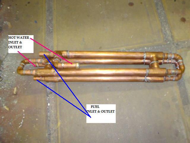

      Knocked mine up out of 22 & 15mm copper tube and some fittings, then had it nickle plated (£5), make friends with a plumber

                    Yes there was an issue involving copper and veg, the copper degrades the veg tho how quickly this happens i dont know, plus the research for this was carried out by a dutch or someone instuite regarding food grade veg storage,but i'd guess it would'nt be in there long enough to bugga the veg up, however with this in mind thats why i had my one nickle plated, the bloke reccons it would plate inside as well, also had the tank one plated as well,
                    the hot water method dose'nt help cold starting on veg and i did plan to add a swirl tank with a glow plug in it and fit some heater tape on the lines but as the price of veg has shot up it's hardly worth the expense, so next plan was just make a long range tank out of it, i'll finish it one of these days,
                    i did'nt fancy useing one of those heaters mentioned as it's small and think theres a good chance of the glow plug burning the oil, dont know what temp setting the stat switch is set at but i'd be happier if it was in a slightly larger resovoir,
