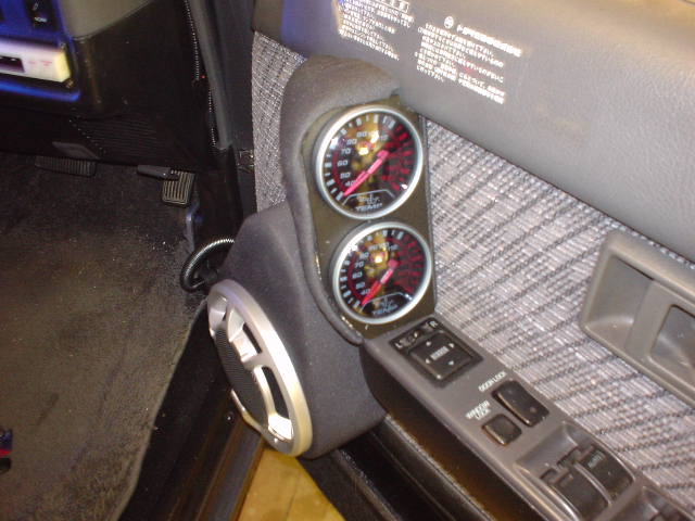

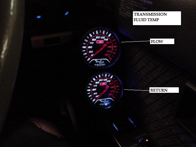

        • #49
          Originally posted by steved View Post
          You can't over cool a auto box don't waste your time or money putting on something you don't need.
          You can, but its hard work, I tend to agree with steve for here in the UK, AFT fluid gets stupidly hot, stupidly quick when driving even vaguly quickly, let alone towing and offroading, so cooling it should be your No1 priorty.
          Fit gauges on the ATF lines like Ian has, and go for a test drive in your local conditions and see what happens is the only way to know for sure.
          Toyota say 70-80 deg is normal operating temp, and at least 50 before you start messing about testing things.
          We have a stand alone B&M Supercooler, and the ATF no longer goes through the rad at all and things seem fine.
