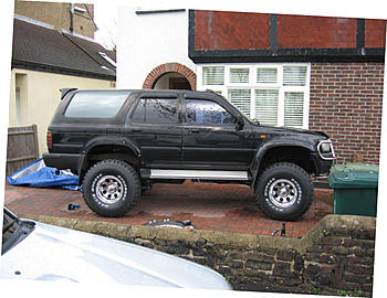

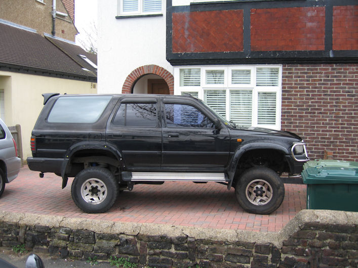

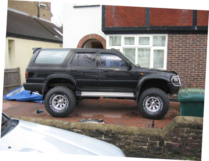

    Well my alloys arrived and I have they tyres so it was time to put them on.
    Such a difference they make, suddenly my car does not look like a set of roller skates.
    Now just need to sort out the front tyres rubbing on the mud flap and then I can send the car down to tony to fix the gear stick and I can drive it again.
    Oh the car has a 2" body lift, a 4" procomp suspension lift, the alloys are from la super trucks and are mickey thompson classics 10" wide (cant remember the offset). and the tyres are maxxis buckshot mudders (or something) 35"x12.5xR15.
    They are amazing and look great.
    Pictures are before......... right side done....... and after
    Had a couple of problems getting the tyres on the alloys most places either said they could not do it or wanted 20 quid a tyre!!! finally found some big old guy down some back road who did a great job for not that much (I will have to use him for my other cars from now on). The only other thing is the alloys are not lacquered so with the salt etc on the roads here I will have to pollish and protect them, but I think thats a small price to pay for some amazing wheels

                      Look ace, big improvement, just wondering how much they might rub on lock or with articulation off road?
                      Alan
                        Awesome!! Mickey's look the nuts! Great choice! Nice to see another truck with an IFS bracket lift! Welcome to the 35" club mate!
                        They will never be as good as 33" offroad in a Surf. you may have that extra 1" diff clearance... but buy a bash plate. a 33" tyre can stuff into the arch a hell of alot better then a 35" ... they are pretty damn big.
                        you'll always be driving to avoid ripping your tyres/arches apart on really tough sections which will mean it would make a tough section ....tougher!!!
                        Unless you put in some extra bump stops an some diff locks so limited articulation wasnt much of an issue.
                          rubs on full lock at the moment,
                          I need to trim the mud flap inner edge a bit and then see.
