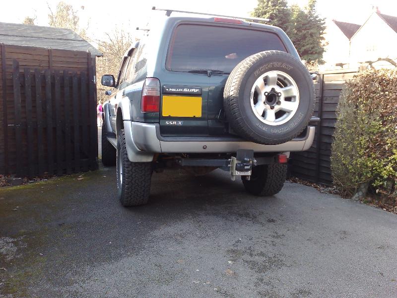

    Yes it's a 3rd gen problem. The spare gets in the way of hitching up the trailer. Can I get the bits to put it underneath in the well provided? If so does anyone have them?

              how much more clearance do you need? and in what direction, horizontal or vertical? would a 1" or 1.5" spacer between the towball and tow bar be enough?

                The lock handle on the trailer ball hitch jams on the spare, so you have partly open the wheel mount and then it sometimes is difficult to get it closed again past the jockey-wheel handle. This depends on the slope.
                Putting the spare underneath would be fine, I could always put it back if I need to.
                  a drop plate to lower the towball by an inch or two? Or is this gonna throw the trailer balance out, does the trailer sit level on the surf now or is it nose up a little? If it's nose up a drop plate should balance the trailer better aswell as giving you a little more clearance.
                  Are the 3rd gen winches for the underslung spare the same as 2nd? If they're not you may have a hard time finding one, there ain't that many 3rd gens about with underslung spare.

                    A drop plate might do it, but it would have to be quite a drop!
                      How about an adjustable hitch?
