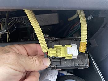

                          I had the same problem. I just unplugged it here
