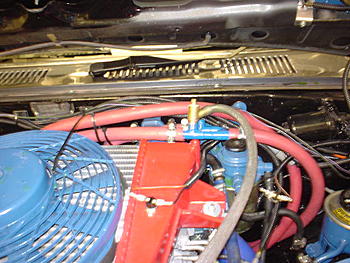

    well i think ive made burping the system easier now, i noticed how the system is an arse to burp due to the water pipe at the back of the engine (think its from the heater system) being higher up than the engine and the filler for the rad,
    so a trip to b&q was required,
    i bought
    . a 15mm copper t-piece
    . a radiator draining tap
    total cost £4
    i cut the pipe at the back and jubilee clipped the T-piece in place, then attached the drain tap to the T-piece, just pushes in and clicks in place.
    now i can bleed the air out the system from the front and the back of the system,
    jobs a guddun
    ill put some pics up tomorrow

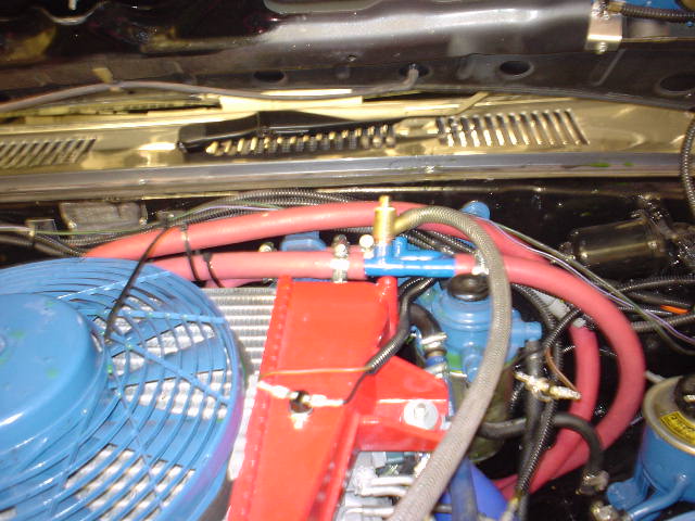

          thtas basically what i did with it,
          only difference is the bleed valve i used. but it works a treat
          nice one
            Here's mine, makes it easier dont it?
              ah ha , thats the same tap/valve ive used.
              must mean i did something right then
