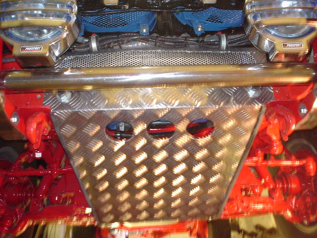

Came acroos some Checker plate alluminium, about 5mm thick, chopped off the top of the original bash plate, and remounted it flush to the chassis, instead of being 5-6" down from it as was before, then rivited ally to original plate, and bolted it all up. It was strong before but now it should take fair thwack to upset it.
