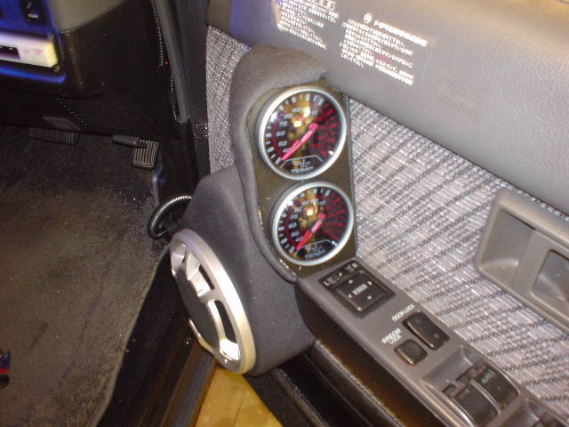

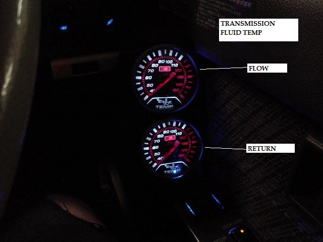

got these fitted and wired (well nearly) today, ATF temp flow and return,
a bit of non-essential bling but ya know how i love it

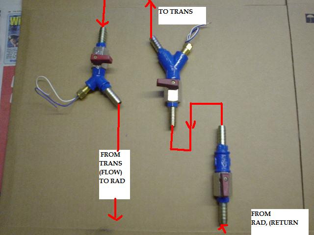

i hope) without looseing oil,
) plumb thermostats and bypasses for when its cold, but I don't think its really a problem, and the Bullets has been fine for the last year that we've been running it like it, with it completely out of the main rad.
