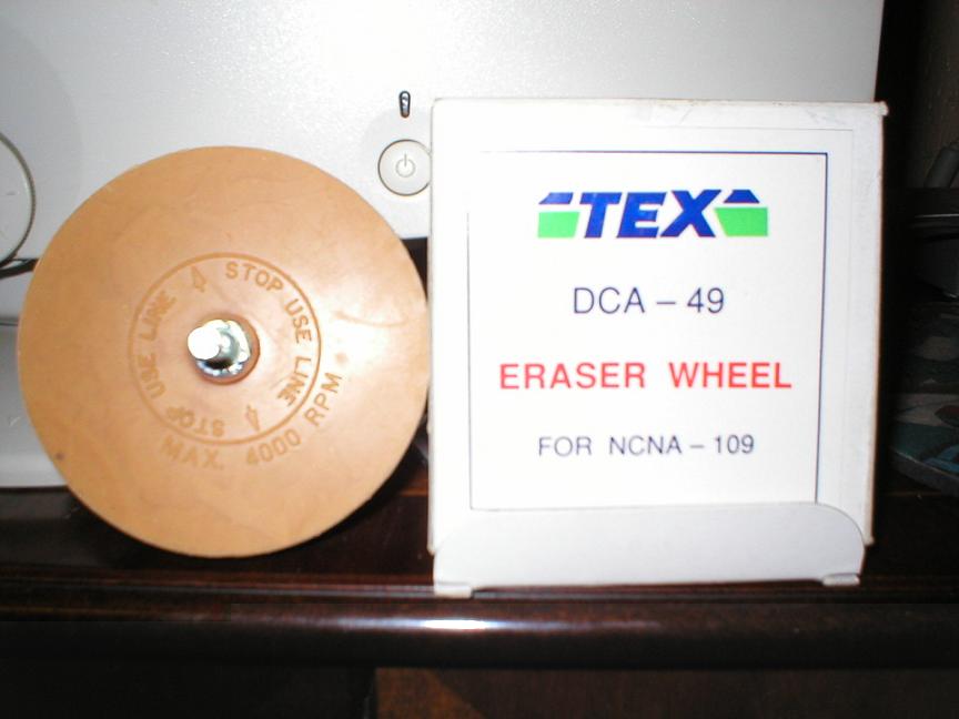

    white spirit, although if you had posted before you done it you could have used one of these, takes the glue off as well, no good for the glue alone though
