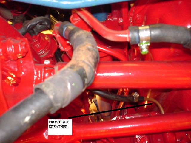

                              diff breathers? is that front and back? wot about the one on the gearbox?

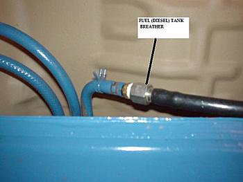

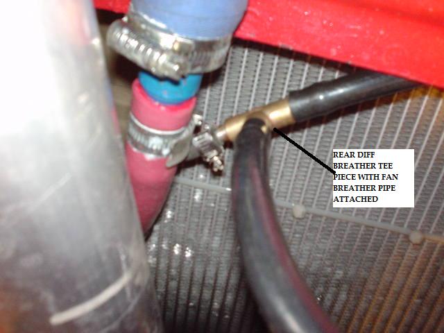

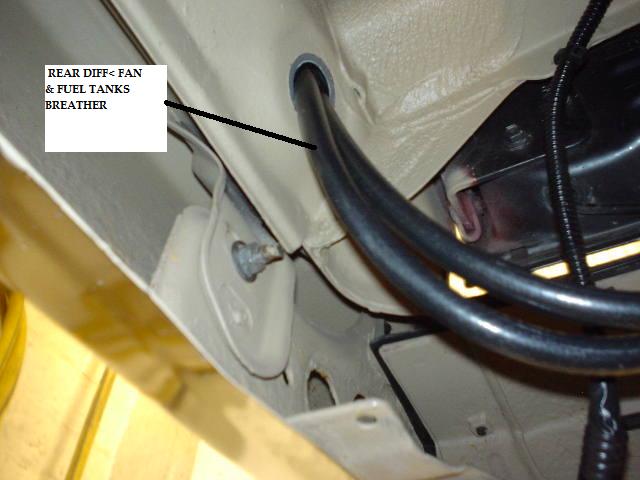

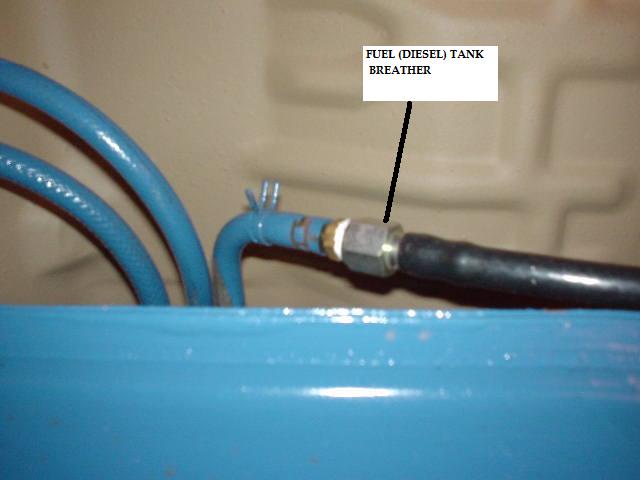

                              i managed to find a couple of air fittings that went straight in (need another one for the box) and teed in the fuel tank and fan, just need to do the veg tank,
