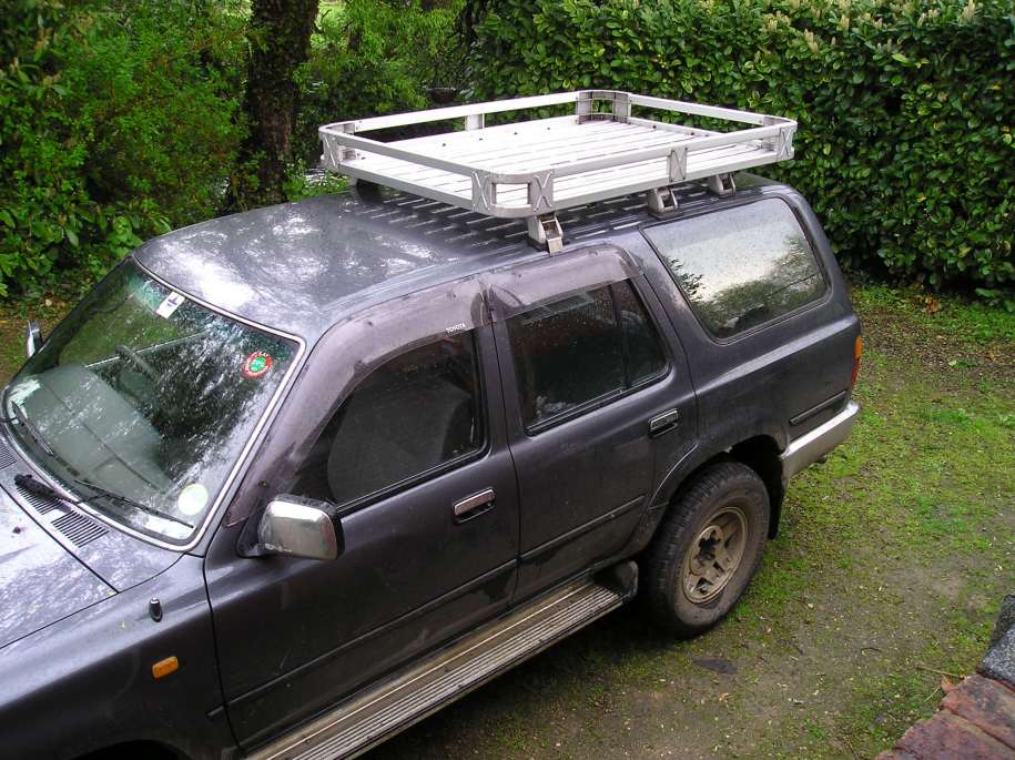

apache, you lookin at my rack?
Very nice!
I also note from the other post that nowhere did you drop the slightest hint at all that you might want to sell it
I'm just in thwarted-spend mode after that other wally paid £280 for similar!Cutting steps in the roof of the world

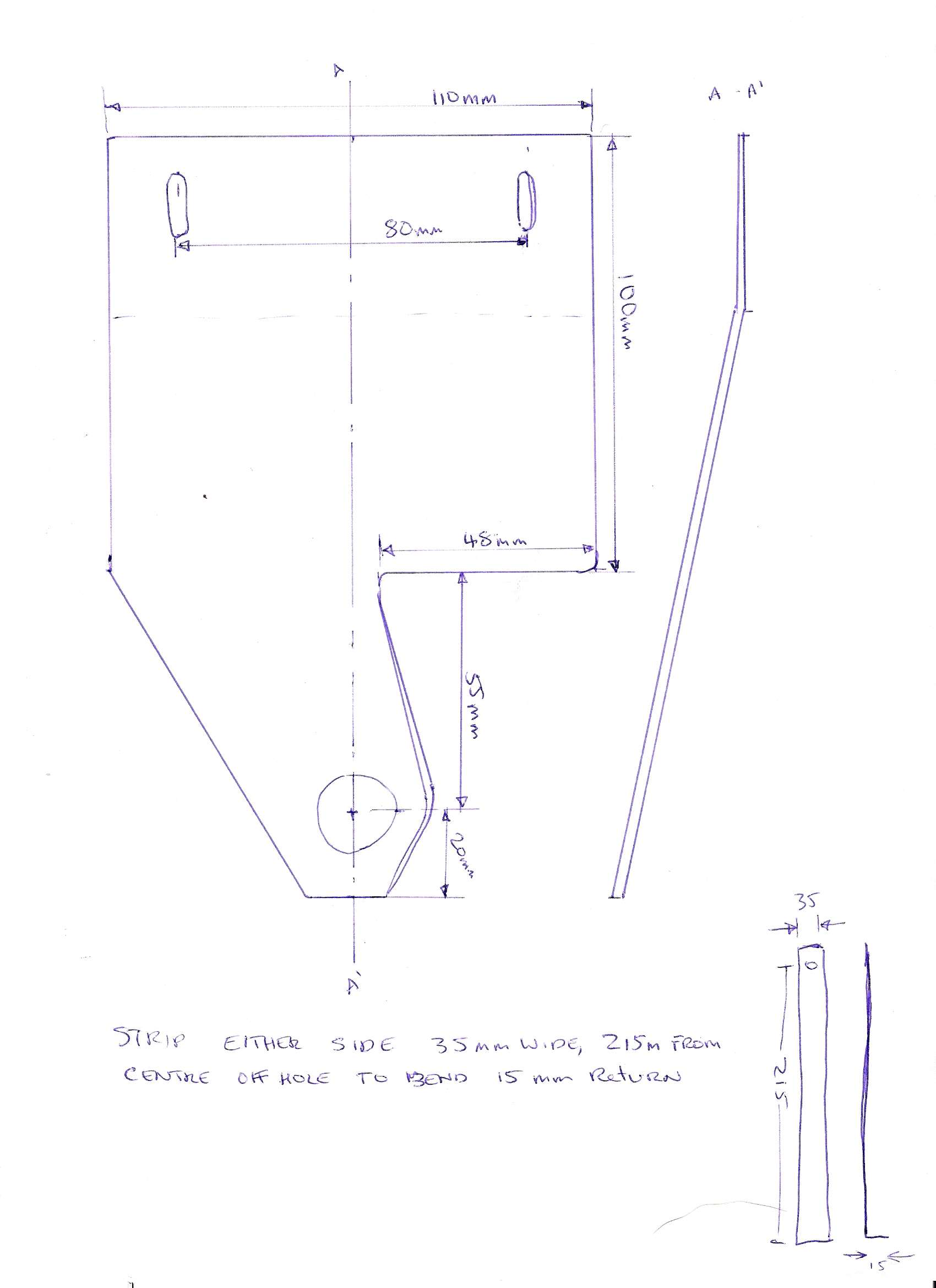

I've been looking at 1" box section aircraft grade ally as the material. I reckon the rack itself should be a doddle to build, but the mounts would be harder. Dunno whether to just drill the roof and mount it permanently.Cutting steps in the roof of the world
