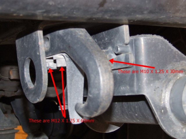

a bar,whot size bolts??
  • #31
    Originally posted by breakdowntruck2
    ok and 2 bolts per side?and i only have one hook so 60mm on one side 30mm on other?
    Thats it mate! spot on!
    • #32
      thank god!! me look thick??neverrrrrrrrrrrrrr lol
      • #33
        Nearly right. 30mm on one side and 60mm on the other side.

                    • #40
                      Originally posted by smiffy
                      Theres an additional bracket you'll need. It's held in place with the same bolts as the hooks. The A bar has a fixed bracket either side with 2 holes and a wee lug that sits on the bracket thats bolted to the hooks.
                      If that makes sense!!!
                      Correct. Here's a pic. A bar bolts can't be seen but arrow shows where to look.
                      Nev
