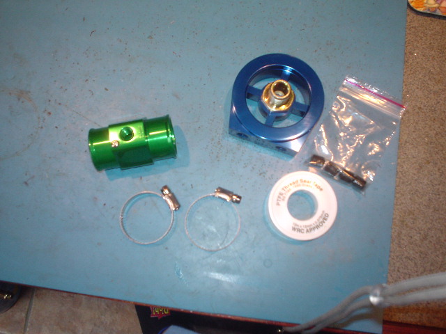

    Has anyone used one of these before ?

    No but it has to be a very reliable way to do it. I have mine in the front of the thermostat housing as theres a nut that makes room for another sender.

      I've got a similar one but yet to install. A few on the Aussie site are now using them for an extra gauge in the top hose and one is also installing one in the bottom hose to monitor temperature from radiator to engine. You need 32mm for the Surf.

          I used one on the 2.4 for the electric fan sensor - seemed to work ok. The 3.0 top hose is bigger than the 2.4 - can't remember by how much off the top of my head, but it is different.

            so this would be ok to put in the top hose as outlet for secondary temp guage then ?

              Yep. As long as it's an electronic gauge which are 1/8 NPT. Mechanical gauges use a different fitting. They are usually a 5/8 UNF to a M16 adapter into the hose adapter.

                  Just ordered two of the below to monitor the veg temp at the tank and exchanger,i'll need a appropate tee piece for the exch, those water temp adaptors dont come in small enough bores for fuel line, they are good for water temp gauge however, stuck one in over a yaer ago, dont forget if you fit it in the top hose (like i did) it wont regester till the stat opens, not a bad thing tho, it's a pity the oil pressure "O" pot adaptor dont fit the surf, (the blue thing in the pic) think Nev will confirm the surf is one of only to vehicles they wont fit, even tho the guy said "it'll fit your truck" right, prob is even if they made one that fitted the oil filter would hit the steering shaft,

                  PS: dont forget to run an earth wire to the adaptor, it should come with a screw for that, as ya see in the piccy

                        I can see without knowing the size that it will not fit the Surf. When they say they will fit they are thinking of non turbo models with the smaller diameter filter which can be fitted with this type. You are correct in saying even if they did they would hit the steering shaft unless a very low profile one was made.. I have searched the world for a Surf adapter and never found one that will fit yet. I may design and make some when I get the time

                            For water? i think the guys got one left (water) but any water temp gauge will do ya, as said you can get one of them adaptors or get a reduceing bush and stick the sender into the filler neck, theres a blancing plug just under the fan sensor switch, dont know the size bush you'll need apart from the temp sender will prob be 1/8th npt, BTW the gauge i linked is an oil temp although it's prob the same bl00dy gauge with either water or oil writen in it
                            there ya go!! (no idea why it's 3 quid more than the oil one's
                            slight amendment, the blancing plugs to the front and above the sensor, just under the water feed to the turbo, might as well have it right
