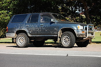

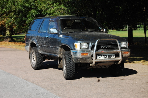

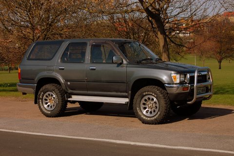

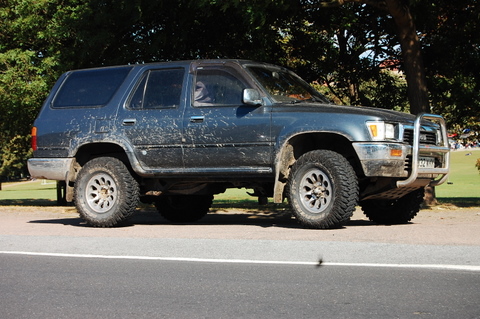

    Hi all, as you may or may not remember ( or care for that matter) this year I had new suspension fitted, with the +20% springs from r/trax, and all seemed well.
    Last week I removed my side steps, and noticed the rear end looked a bit low.
    So here are some before and after pics of the side step mod, and the rear does look low to me, or is it just tht the front is too high.
    If I fitted the L/C80 springs, would that look better ( 3" lift at the rear) and left the front as is ( maybe fit some bj spacers)
    Oh, and does it look better without the running boards or not?
    What do you all think?

    Without, definately.

      side steps off! 100% improvement!
      now... honestly i dont think its that bad, the rear arch is lower on a surf anyway so it can really throw you out when looking for the S.A.S!
      If im lying... that a$$ is sagging! Get yourself some LC springs an some BJspacers!! Muahahaha
      lift it! you know you want too.....

        I think actually it does look better without side steps, and i didnt think it would, might even take mine off now. The photo from side does make it look a bit low, but the one from front looks fine. Straight anyway. Although it would look fantastic with another coupl o inches on the rear. Rim to wheel arch stock height is 13.5 inches on the front, any more than 15 inches and thats too much for your cv's (so im told).

            they always look better with the steps removed.as for the sas.i wouldnt say it looks as though you have a saggy bottom.but if you fitted the h/d lc springs and played around with the front torsion bars added bj spacers and a diff drop kit.it will look better still.

                  I think it looks far more impressive without the side steps. Although, I find it difficult to get in without them and have to kinda throw myself onto the seat. That was in a crew cab hilux pickup.

                    I hope it ain't sagging, as the springs are basically new.
                    As far as the LC springs etc go, I would need various mods to get that done, longer shocks/brake lines etc, and my shocks were new at the same time as the springs.
                    I would like to do body and sus lift at some point, but that maybe next year when ( hopefully) the finances are better.
                    I thought about coil spacers, but they cost as much as new springs, so I don't see the point.
                    Agreed, I like it without the side steps, looks less towny, if you know what I mean.
