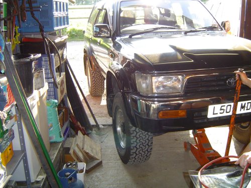

Originally posted by TonyNYeah, you don't need anything else. the spacers bolt to the hubs using your old nuts, and then you bolt the wheel to the spacers lug bolts.
If you have long/bling wheel nuts, use the nuts supplied to bolt the spacers on, and use your nuts on the wheel.
They are 30 or 32mm, can't remember off the top of my head.(\__/)
Originally posted by SanchoSeeing as there's a big rush, what are they actually for? I thought they were there to make 'the wrong' wheels fit.Paul </Slugsie>
Immortal.so far!
Plus it looks better with the wheels filling out the arches more,
I was lucky enough to get some steel ones from Trackstore at the discount they were doing just before they went down the pan, £80 a set and strong a feckToo young to die and too old to give a toss
Originally posted by SlugsieThey increase the width of the track of the car. This slightly increases the stability of the car when cornering/on a bank. It also gives the car a slightly meaner looking stance.
(Goes outside to look at truck, thinks that wheels would indeed look better further out, wonders where camera is, looks at gently spitting rain and contemplates the possibility of snow.....)
So why didn't Mr Toyota put the hubs further out?
Originally posted by SanchoSo why didn't Mr Toyota put the hubs further out?
The Land Cruiser LJ70's have exactly the same style of alloy, but with -30mm offset, so the tyres ends up in the same place as with spacers on a Sruf alloy.
GT Dog used to have a set on his Surf. (they are in my back garden now....) and I've seen others as well.
