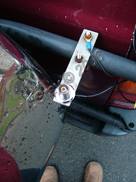

                Give Lynchy a ring he does a good range of roof rail mounts plus a full range of bootlip mounts.. I run the Maldol HMC 6 mounted on the spare wheel hanger
                Im not a gynacologist but ill have a look
                • #23
                  I would associate Lynchy with selling radio's / boxes mainly and not this sort of thing. But maybe that's what being off air for years does to you.
                  Anyway, went down B&Q today and came back with some U bolts and a suitable steel bracket. So tomorrow's mission is to do some bodging. Its going to be attached to the spare wheel arm too. Thanks Toyota!
                  Andrew
                  Regards,
                  Andrew
                  G0RVM

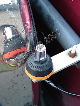

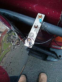

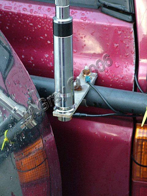

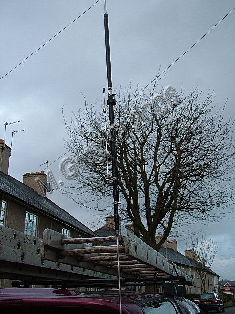

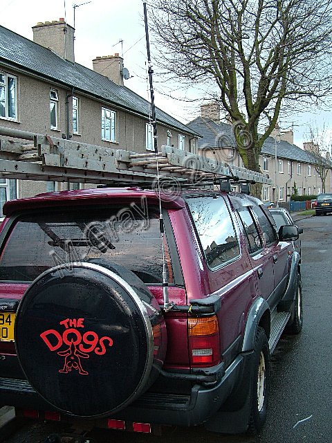

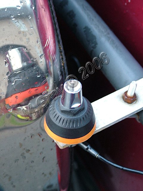

                      Have a look here these guys understand the radio side of things a lot more in detail than the average CB dealer they do a very good triple magmount that even the heavyiest aerial on it would not pull it off the roof. But if you have a spare wheel hanger on the back that is the most convenient place to site a mount. I have recently replaced my 239 mount for some low loss LDV coax which has a very thin section ideally suited to go through doors without getting squashed by the door. With all HF installations you can not get enough earth Lynchy does a earth line which is attached at the aerial mount to which you then bond to the chassis there are cheaper methods but you pays for what you get.. One of my radios has the facility to use a magic aerial that can electrically tune itself from 7Mhz to 433Mhz and to this you do need to have as best an earth that you can. Mag mounts on their own on HF are not the best solution as they work on capacitance as opposed to a direct bonding to earth..Your average CB aerial uses a 3/8 thread where as most of the good amateur aerials use 259 mounts the later giveing the better conductivity and on top of that if i need to change band all the aerials are made to the same standard. This also gives me the advantage of when i sit on the Yorkshire moors with a kite antenna up i can use the mount as a means of getting the aerial into the car and staying warm...
                      Ive attached some pics of the mount i use and its flexibility with my 6 band HF to UHF aerial on it also i have the adapter to use the US 3/8 aerials as well. you will see the thin feeder which increases to better quality feeder inside the car all of this is low loss coax.On this mmount i do occasionally use a 9ft steel whip on HF mobile so it is a strong system.

                        Tryin to turn your surf into a Tram...3rd piccie looks like your going to connect upto the overhead lines
                        Gaz
