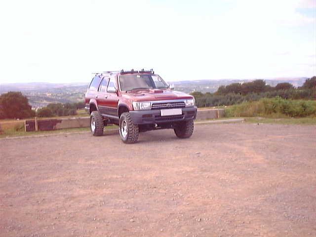

    well guys im almost there,just the rad and exhaust to go.then i will be hitting the streets.so watch out.http://s86.photobucket.com/albums/k113/vatchman/

    Awesome, and you've gained an instant front end lift. Amazing how light the rover V8 is compared to the diesel lump.
    Ian 619 is enquiring about some exhaust manifolds from his neighbour.
      yea,i reckon ive saved somewhere in the region of a couple of hundred kilos.that aside from the body lift as well,so me thinks a set of uprated rear springs is in order.

        Ooh, ooh, get some Landcruiser springs, and I can supply the panhard rod drop bracket kit!
        Did you find the charge light wire from the alternator?
          ive been reading the thread about the springs with great interest.is it a difficult job to do.as for the alternator wire i had forgotten about that.best i go have a look.
          www.overfab.uk
            If you install a V8 into a Surf, you could fit the rear springs with your eyes closed!
              so whats needed then vince and whats the cost,
                      Landcruiser HDJ80 rear springs from Milners, £44+tax Lifts the rear 3"
                      Procomp ES3000 rear shocks, £35 each,
                      Panhard rod and anti rollbar relocation brackets + all nuts and bolts from me, £47 to your door!
                        im all exited,that may be a result.can i remove the anti roll bar and leave it off
                          Yep. The Landcruiser springs are firm enough not to notice the rollbar missing.
                            right where do i sign up for this kit then vince.
                              You order the shocks from here...http://www.explorerprocomp.co.uk/aca...rs_ES3000.html
                              Rear springs from here...http://www.milneroffroad.com/HDJ80.HTM
                              I'll PM you the rest.
