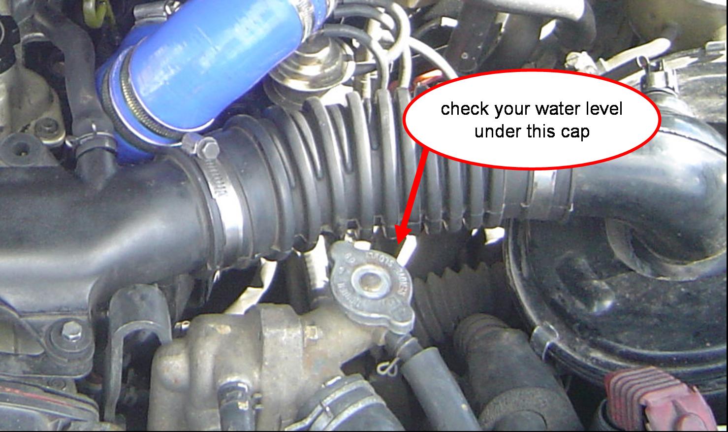

          When you say half full, are you referring to the overflow bottle????
          You need to be checking, with a cold engine, the water level under the rad cap. See pic.
          As stated, check all hoses - you are driving a 15 year old car so things will start to perish.
          However, if you didn't put water in when you were on the hard shoulder, the next 15 miles would not have helped, that's for sure.

            Does the water need to be full under that cap then? When I filled the water up a copule days ago, I put it into the bottle with the cap.
