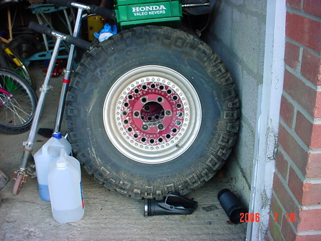

You might want to read this if like me your thinking of removeing the center's of your split rims to "do" em up, Dont know if all split rims are like this but mine are actually three peice, I did ask on the last post if i should let the air out first but was advised i should'nt have to however i dont trust anything with compressed air in it so i did let some air out, Managed to loosen all the bolts and was a third of the way round removeing em and there was a sudden rush of air, i nearly $hit myself, the rim is in two parts and is bolted either side of the center so im no nearer removeing it, i would have to get the tyres taken off first and cant be arsed plus the cost, in theory i suppose you could remove the tyres one the rim is split by levering em apart but im scared of buggering up the mateing faces ie rim to rim and rim to tyre, Suppose i'll just have to be very carefull with the paint stripper, it'll be a bit easier with the bolts removed though,
Anyway for christs sake let the air out first in case it goes off in your face
