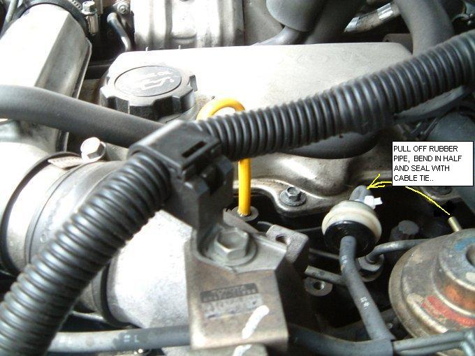

    ...Has anyone found that the engine tends to over-run for a second or so after it's switched off?
    Did mine tonight then tootled off down the road. I can't say that I noticed much difference and thought maybe the valve was already stuck shut, but I was only out for 5 mins or so and it's a bit of a subjective thing anyway...so, parked up, switched off, but as I mentioned above, the engine kept running which it didn't do before.
    Any thoughts?

        No turbo timer unfortunatley...I'm wondering if I've pulled the right pipe out!
        Carpe Biscalorum...
          This is on a 2.4 engine, but should be the same area as yours.
            Oh SH*TE!!, I've pulled one off from further round the back than that....
            Oh dear, oh dear, oh dear....I'm going to have to wire up the engine bay with some kind of electric cattle fence thingy, then I might stay away from it....
            BTW Bush, thanks for the pic.
            Carpe Biscalorum...
              Well, thats fixed the over-run. Anyone know what I originally disconnected?
              It was from what looked like a valve similar but smaller than the EGR about six inches further around to the back of the engine bay with a grey ribbed cable coming out the other side from the pipe I disconnected.
              Thanks again Vince...
              Carpe Biscalorum...
