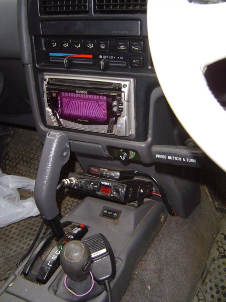

        Ours lives here..............
                  AHH thats where my "KENWOOD" went.
