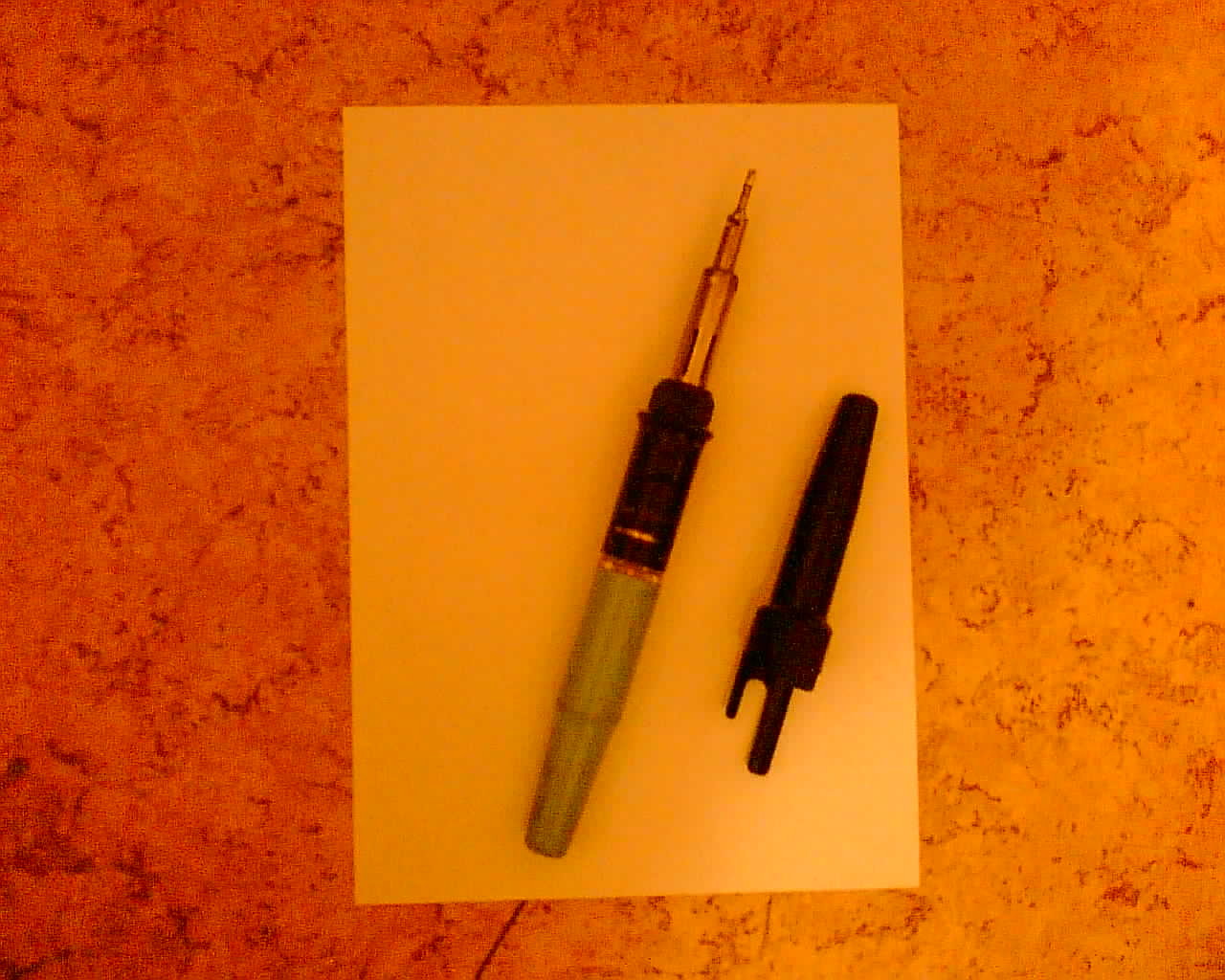

                    This is what i use. It doesn't have a make or model number, just US Patent Nos, but is available through RS components. I have photographed it laying on a sheet of A4 with the lid off, to give an idea of the size. I have used it to solder 14SWG hard drawn copper wire in a gale. There are several different bit sizes available and I think the top setting is equivalent to 120W.
                    It's only a hobby!
