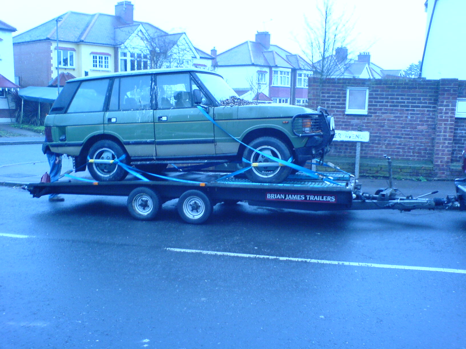

                        Originally posted by TonyN
                        I really should buy a Landcruiser like Lucky's.
                        Tony it copes with stuff like this so well its disgusting - do NOT buy one

                              Weighed my setup last Nov coming back from a fishing trip.
                              Surf, (Inc 3 large guys) weighed in @ 2,073 kgs. Boat and trailer weighed in @ 1,942kgs Total rig =4,015kgs. So i reckon I'm just about road legal And the Surf plays with it no problem (250 miles straight runs).
