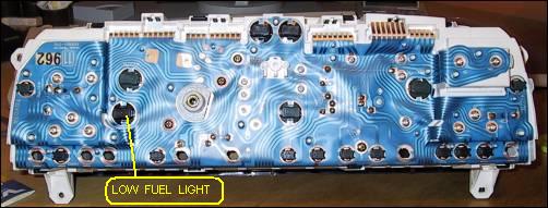

            Maybe your bulb has blown as you say it went bright then dim, as it's the same type of bulb as the dials. see pic.

              so end result from your comms Vince is that i am a $hit bag and don't take it low enough.. it will be goning on and off as i haven't taken it low enough (Just covering the E).. It will be coming on and off because its nearly at the point when it comes on.. starting, stopping cornering etc will make it go on and off as the fuel moves around..
