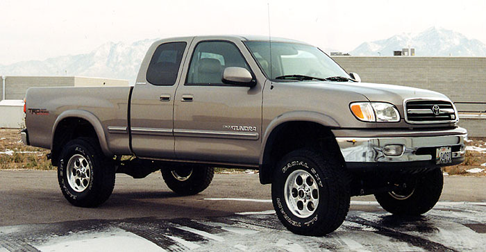

Some nice sounds here. If your Surf sounds like any one of these, I'll be happy.
Scroll down to the bottom of page to hear what a Toyota Tundra pick-up sounds like. Why can't we buy them in this country?

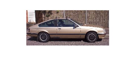

I know exactly what you're on about, I used to have a Vauxhall Royale and was working as a maintenance engineer at the time and I had access to mig. tig. and arc welding equipment and stainless tubing.
Any way the car was a straight six and I made a tuneable rear exhaust box for it so it could just purr, or sound like a full on NASCAR racer all from the twiddle of a couple of grub screws.
