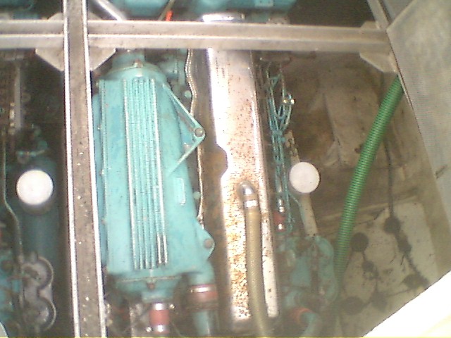

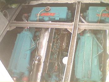

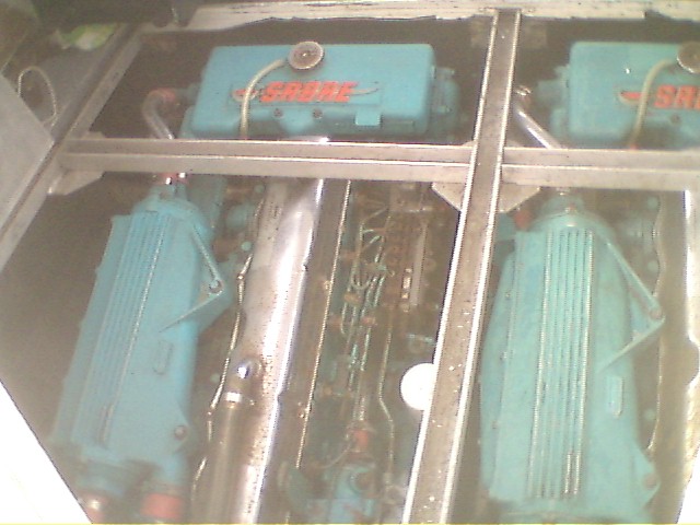

    Sabre 212s 1990 vintage any help?

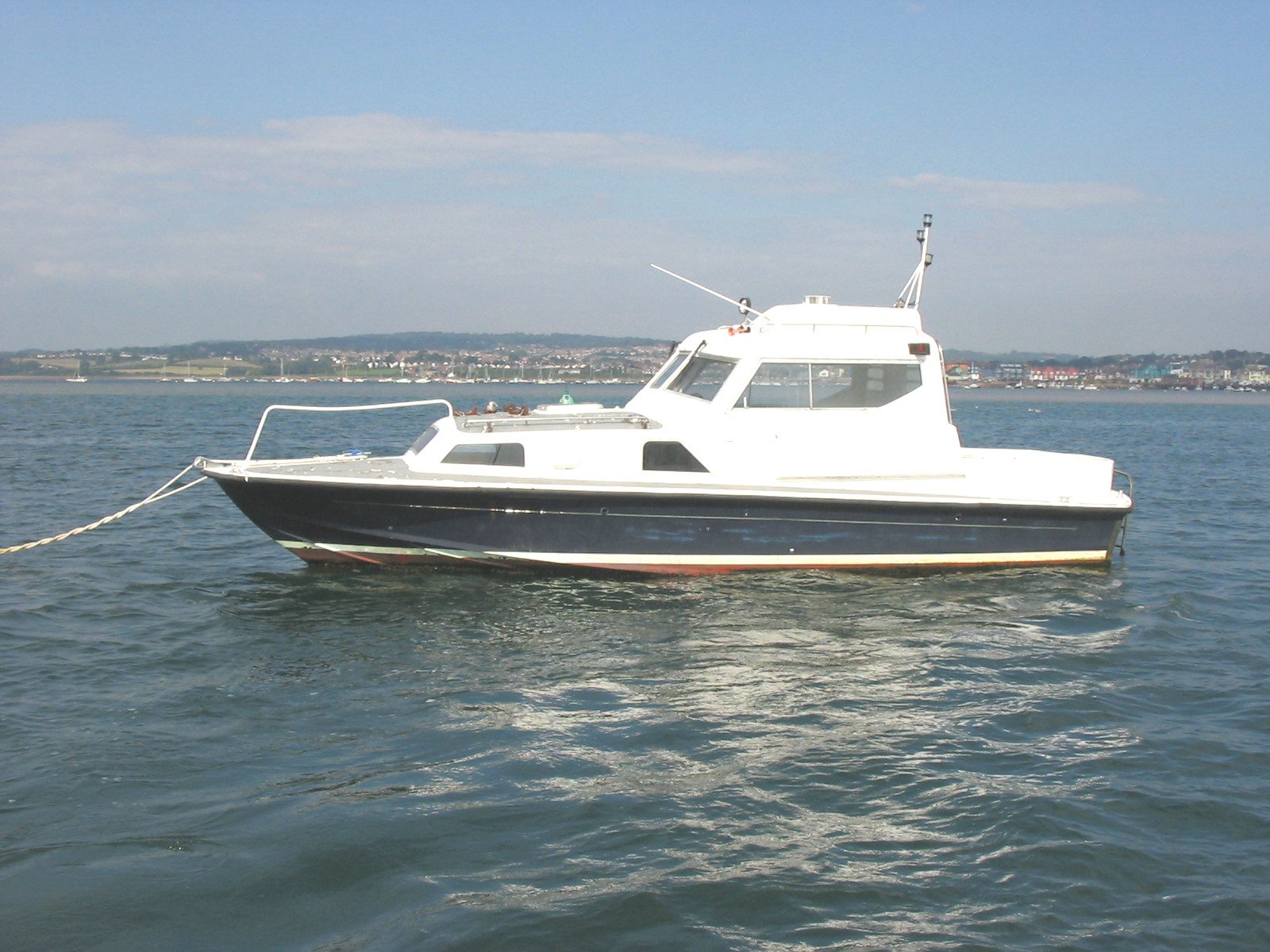

      Yup, our new school boat Juno, a 1977 Fairey Spear, previously used to chase naughty gun runners in NI, and currently having near 30 years of MOD paint s****ed off by yours truly, new exhausts, bathing platform, re-fit and trim. Twin display radar Plotter with intergrated AIS, and DSC radio, and a full cat 2.
      And due in the water in January!
      She looked like this on Thursday last, prior to stripping commencement!

          oh my,brings back fond memorys.right as you know the covers arnt off the shelf items.as we stopped making the fords about ten years ago.so the price for the covers are £25.00 each +vat un-chromed in a nice matt black finish with breather modifications.or for £143.00 each you can have them nice and shiny.a rip off if you ask me.thats the discounted price to.but if you dont mind me saying they look in pretty good nick,compared to some i have seen.so i think a tube or two of autosol metal polish will bring them up like new.if you require new gaskets which you will,because they should be stuck on with evostick.let me know and i will source some for you,that goes for any other engine part.how many hours have they done.and if you give me the engine numbers[they should be on a plate bolted to the engine above the oil filter.or by the flywheel housing]i can trace there service history for you and let you know any major work that has been done on them.

                Cheers, I shall try to get the engine codes, the rocker covers are pretty rusty, but near £300 is more than I can afford at the mo, so I shall probably give you a call for the black ones, also are you able to obtain any Sabre green paint, for either spray or bruch application?

                    there are two cooling systems on the engine one is raw water the other is fresh water,the engines cooling system is the same as a normal engine the only difference is that there is a heat exchanger fitted this is fed raw water [sea water] by a pump driven by the engine as this water passes through the heat exchanger it removes the heat from the fresh water and cools the engine down.there are sacrificial anodes in the form of zinc blocks attached to some engines.this stops them from going rusty,a lot of the corrosion is cause by electrolosis.

                        The only way is to keep the engine bay as dry as poss, during the winter a greenhouse bar heater on a timer, then a hell of a lot preventative maintainance, in the form of WD40 (carefully applied to avaid greased areas sutch as controll cables) and smear vasaline onto any stainless components, as Vatchman says, the annodes built into the engine coolant systems help, but only if the engine is wired correctly, I have just had to fork out £1,000.00 for two new exhausts as the previous ones even though stainless were not wired to the main annode correctly.
                        There is a lovely lesson to be learnt from a nob, who at port solent a few years ago wired the annodes to the positive terminal on the battery, the skin fittings fizzed away like alka seltzers for six hours, then the boat sank.
