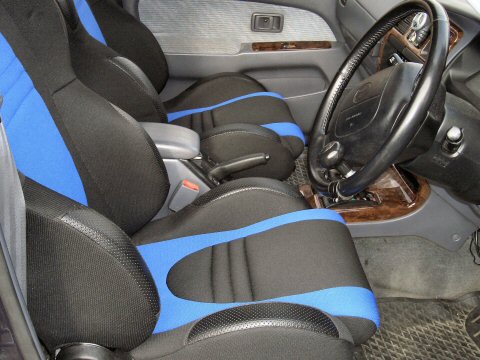

                I fitted some recaro type seats to 3rd Gen, ripped the sub frame off OEM seats and made a sub frame using some 3/4" x 1" box section & 10mm bolts.
                Worked out ok seats solid as OEM ones and have slide adjustment as was.
                  Where did you get those seats from - they look very nice!! Were you able to get a rear seat to match or does it look a bit odd with different seats in the front?
