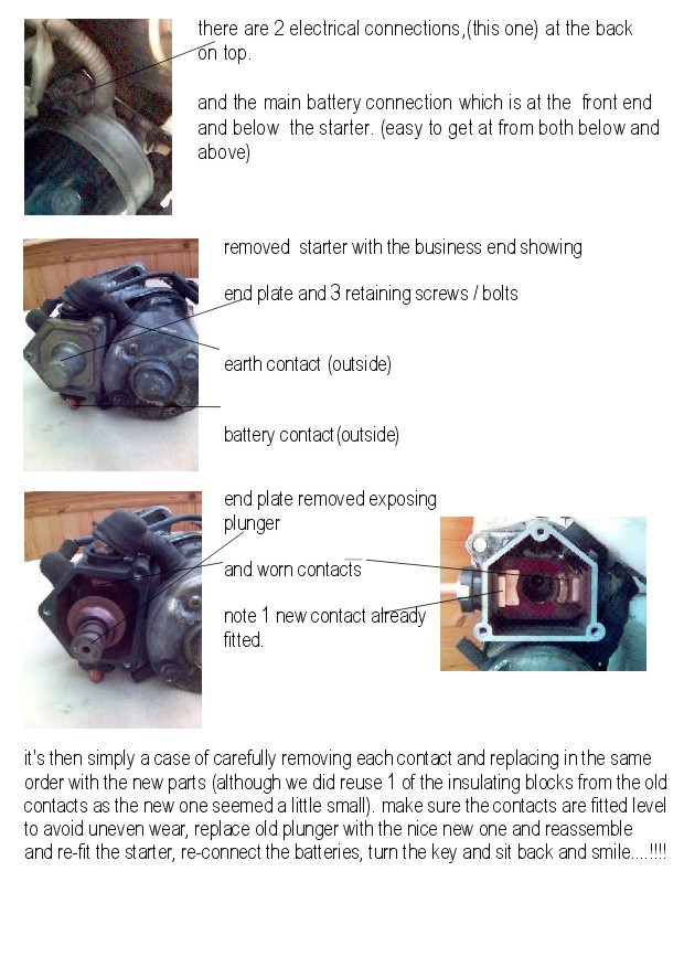

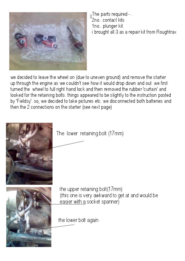

thanks to wakit (who's hiding on here somewhere) i now have a starter that works. we began to follow the instructions posted here recently by (i think) 'Fieldsy' and found that there were a number of differences. so decided to take some pictures that might help someone out one day.
in all the battery was disconnected for 2 hours 20 mins. and that included several cups of coffee and even some sandwiches (thanks to mrs wakit..!!).
