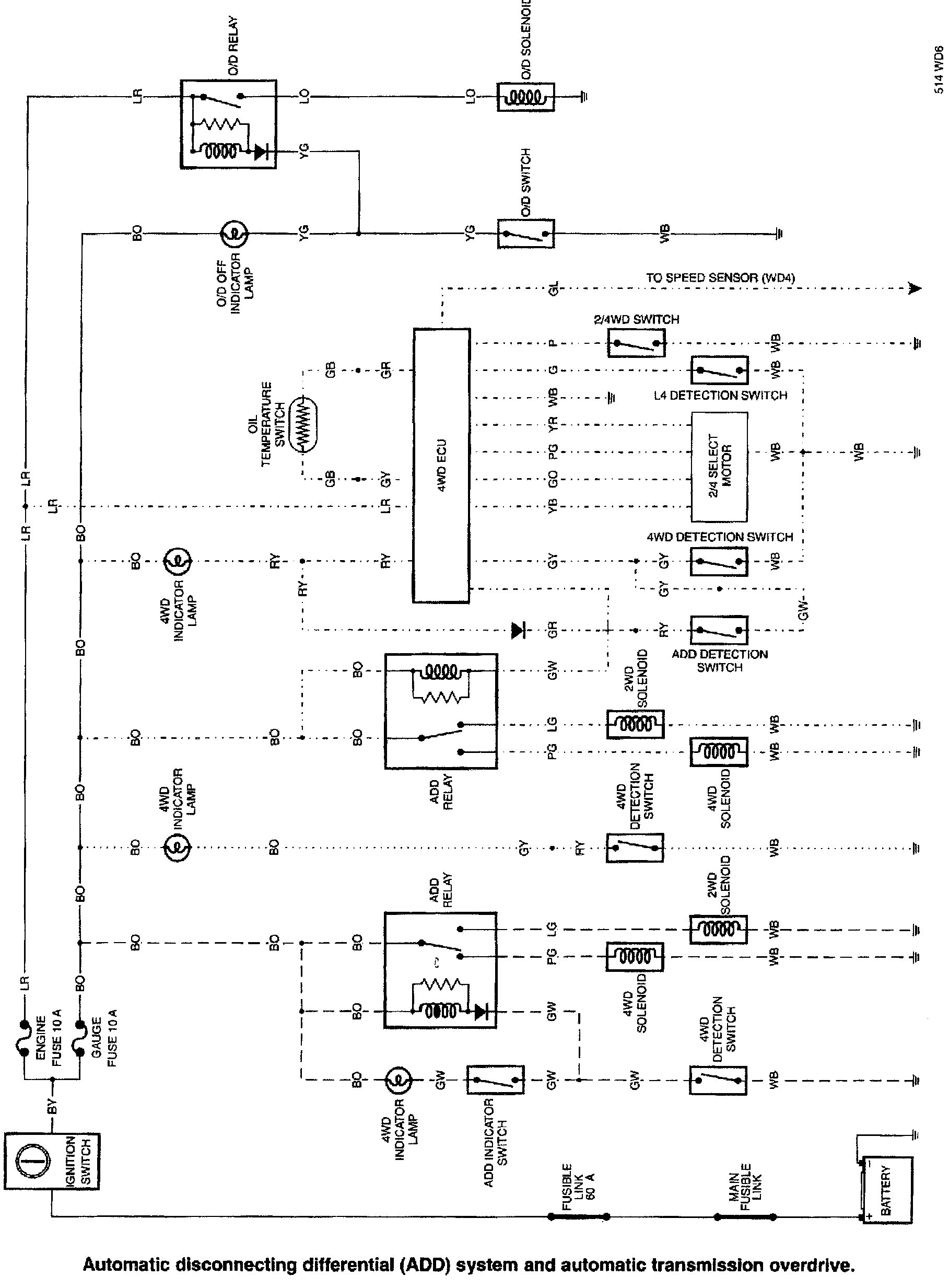

Not sure if this image has worked but... (if it did) is this my ADD relay? (i could email it) It is called COMPUTER, 4WD CONTROL and is 4''x3''x1'' it has a 14 wires to it.
Does anyone have a full wiring diagram of the 4WD system, or know where i can get one?

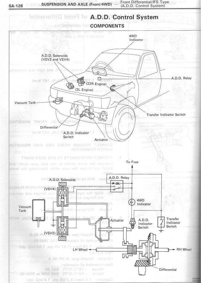

Can anyone tell me the exact location of the ADD relay and how many wires should go to it?
Under the bonnet...One of the solenoids(Brown VSV2)for to 2WD is getting suction. I thought if i swapped the pipe from the other solenoid(blue VSV4) for 4WD. Then this would create suction for the actuator to engage 4WD, but its not?
